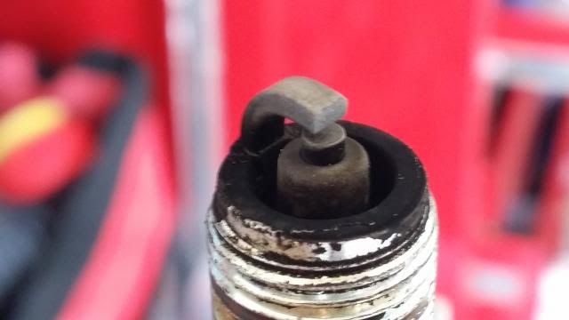

So I decided to pull a plug today and see how its been running, seems to be burning ok looking at the plug so I doubt there will be any dwell issues.

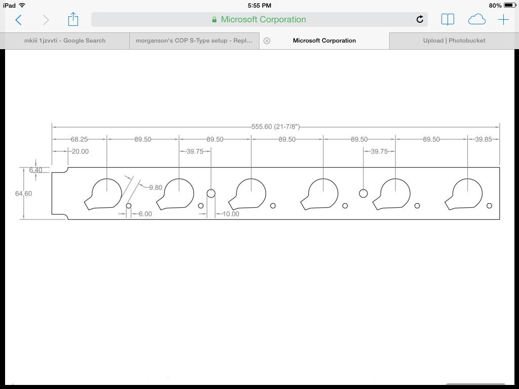

Morganson- can you post all the dimensions that you used for the CAD design?
We could use that as a template if a premade mounting plate ends up being a no-go.
Yes please I would like one also.
morganson
Jan 19, 2012
274
Columbia, SC
Hey guys. Ill get the drawings up tonight. Yes I made the black plate out of phenolic as well. Its heat resistant and strong enough to resist warping even at 1/4 in thick. But its expensive and difficult to find and work with. The aluminum plates will be easier to work with and mass produce as well as offering a polished finish if desired.

I was just waiting for Morgansons go ahead to post this.
I asked my old boss to run one on the CNC for me. I want to test and make sure everything still lines up and that the coils fit properly. Unfortunately he is on vacation so I hope to have the test piece next week.
1986.5supra_kid
Rice? No its Corn (E85)
so 1/4 thick. Supraguy@aol if you have any coils i try getting one made.
the hard part will be making the coil outline. some measurments would be good
