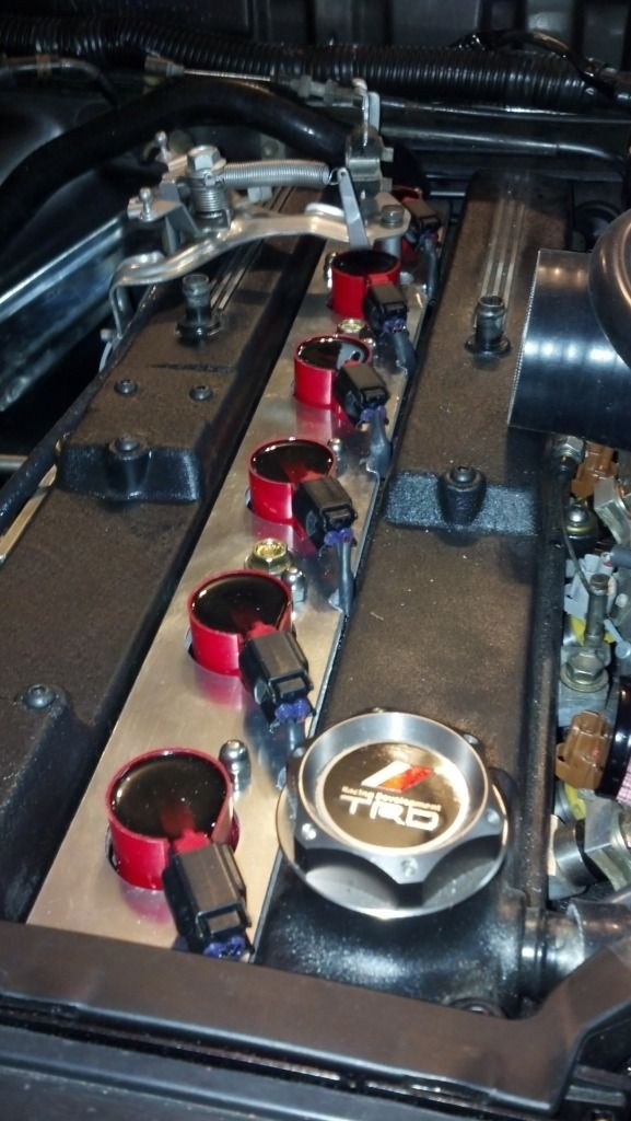

I got these 8 all ground tonight and wiped down, all the tubes cut.
I have one that has a hole misplaced from the first run. Im going to weld it up and redrill, is there anyone going to scotch brite or paint there that could use this one?

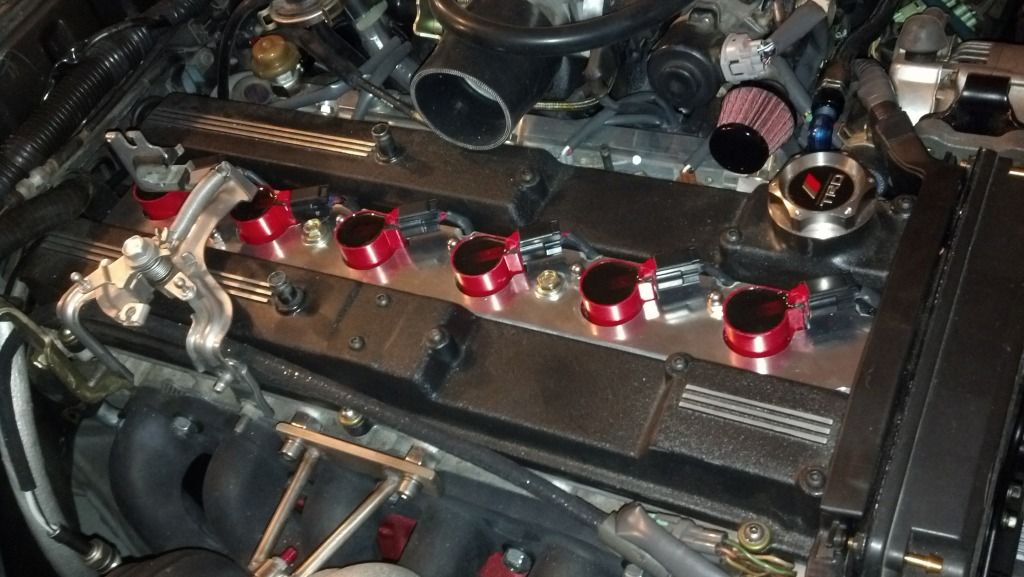

Finished my install today, with harness tucked underneath.
