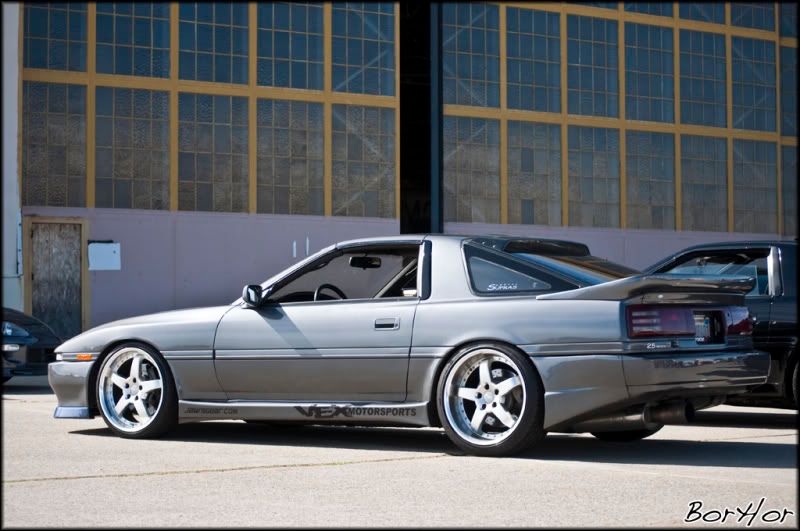

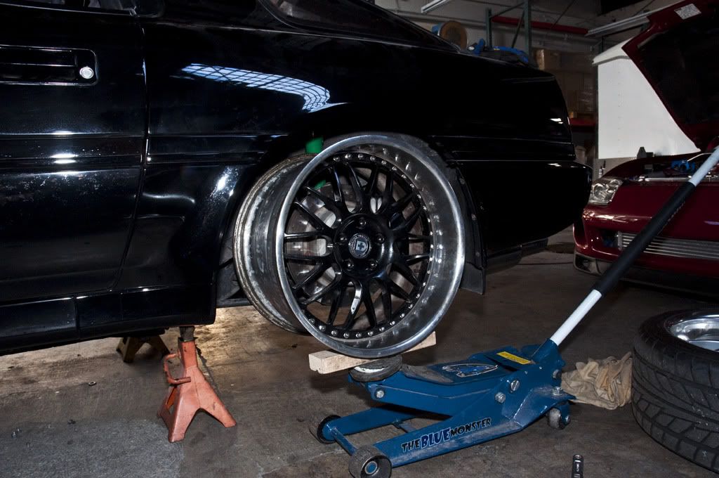

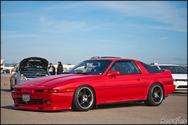

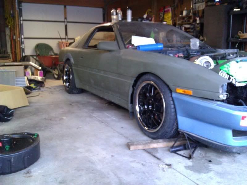

I don't have the manufacture measurements but from what I calculated it is about 19x11.5 +33
I picked up some tires tonight so we will see have happens tomorrow.

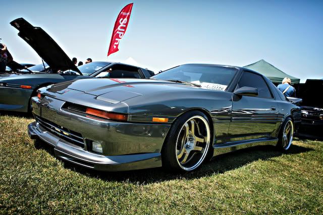

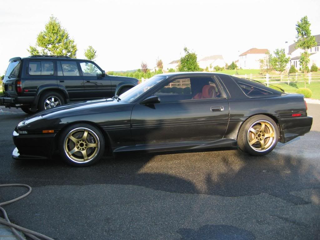

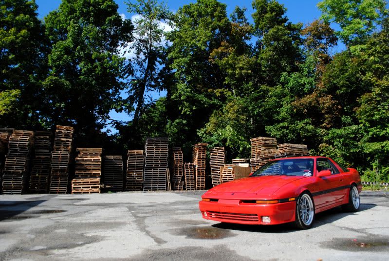

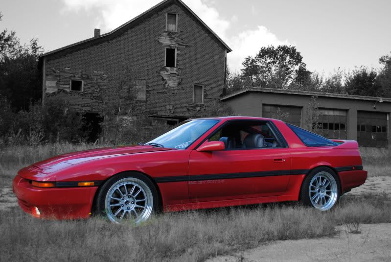

Here is mine. This year I'm adding a 10mm spacer to the front to fill out the flare I created and match the rear a bit better. Contemplating going 15mm front and 5mm rear also... Guess I'll see how the 10mm front looks and go from there.
Enkei RPF1 Type RC
--18x9+18 - 265/35r18 Advan Neova
--18x10+22 - 285/35r18 Michelin Pilot
Bilstein Struts/ST Springs. No coilovers here.

Boris: Thanks! I think that's my next tire size once the Michelin's are worn out, which may be sooner than later. If you know anyone with a good hook up on a used set keep me in mind.
Also, with tires this big, mind the mouldings where they wrap into the wheel well, my tires rub on them pretty bad when the shocks compress, I ended up cutting the moldings and hammering the steel lip out so the tires will clear...
Enraged: Thanks man! I like it :)

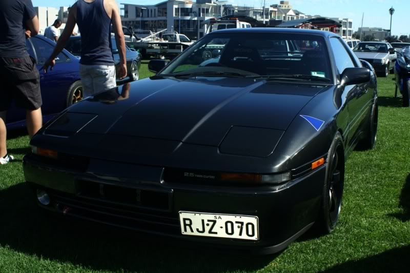

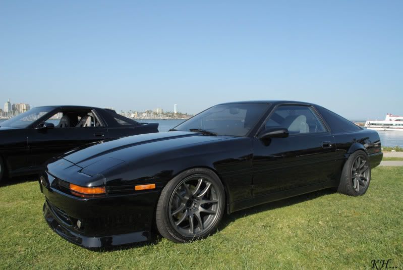

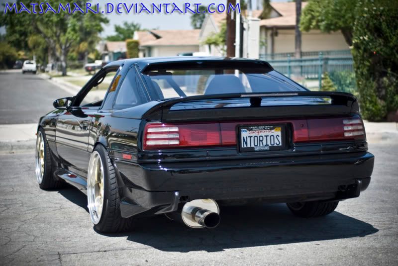

here's an updated photo of my fitment. i went down to a 235/40 at the front and a 265/35 at the back so that i could lower it some more. Doesnt rub on the fenders at all, perfectly functional and I even went to the road course like this. specs are 18x10 +22 rear and 9 +15 front

THIS THIS! I WANT THIS! lol car just looks so aggressive, i will be saving up to pull something like this off hopefully look almost as nice as your car.
