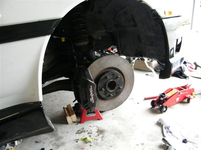

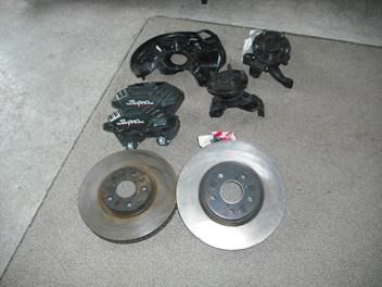

OP: There is a member named mytmk3. He did the MKIV TT front brake conversion. MYTMK3 bought an MKIV "kit" that included a modified hub. No brackets/adapters were used.
Why don't you contact mytmk3?
The components mytmk3 used.

Those really do not look like the disc's from the front of a MKIV to me........Rears maybe.
That's it then, I gotta dig out a front disc here to know for sure.
It seems obvious in the pictures. The left caliper on the first pic is the caliper that is installed on the 2nd pic. I doubt that he installed rear rotors with front calipers. :dunno:

You guys have offered good alternatives to the MKIV TT brakes; however, the OP requested a link to thread about installation front 4 pot brakes from Supra Mk4 to Supra Mk3.
OP: The solution is to contact mytmk3 who has actually installed the MKIV TT brakes.
