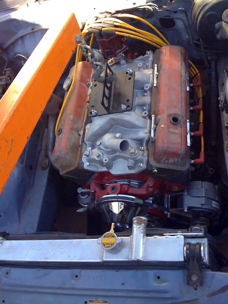

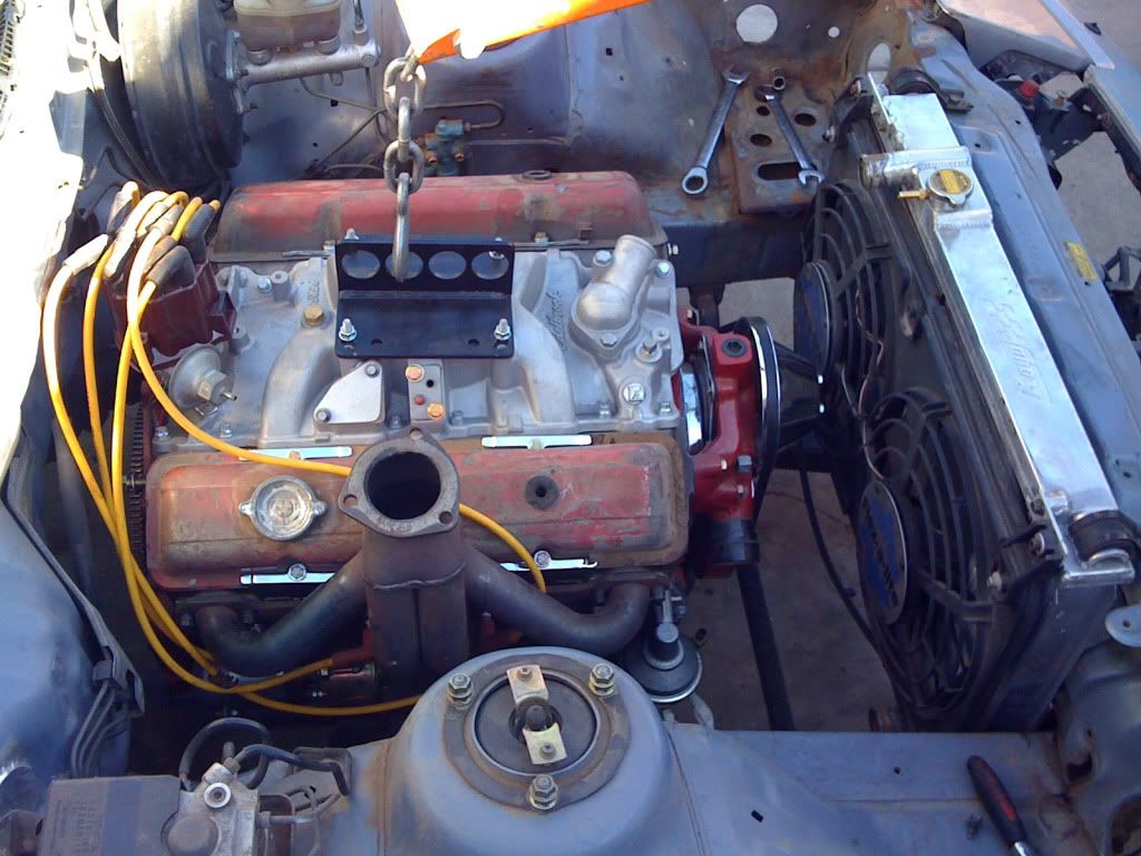

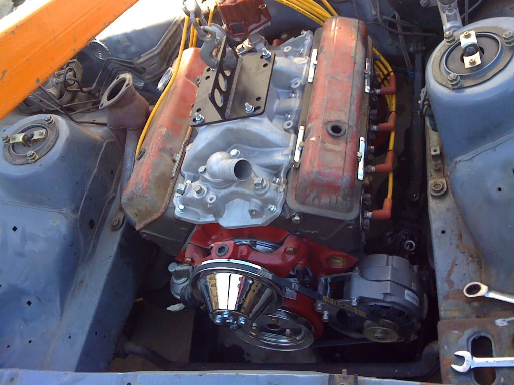

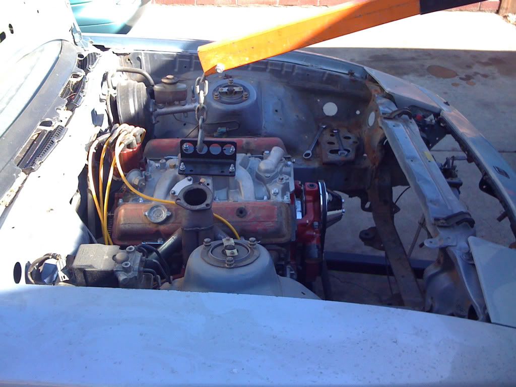

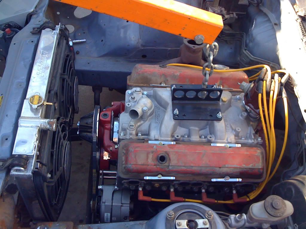

The plan: Keeping it mostly stock for now, to get everything fabbed up (motor mounts, tranny mount, driveshaft, shift linkage, etc) then ill start modding it after its broken in.

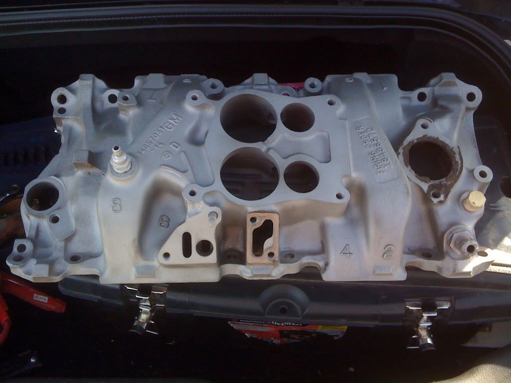

The only mods now is, edelbrock 650 cfm carb, performer intake, msd cap/rotor, accel points delete, msd ignition, and it already was bored .040 over along with headers i find to fit in the supra

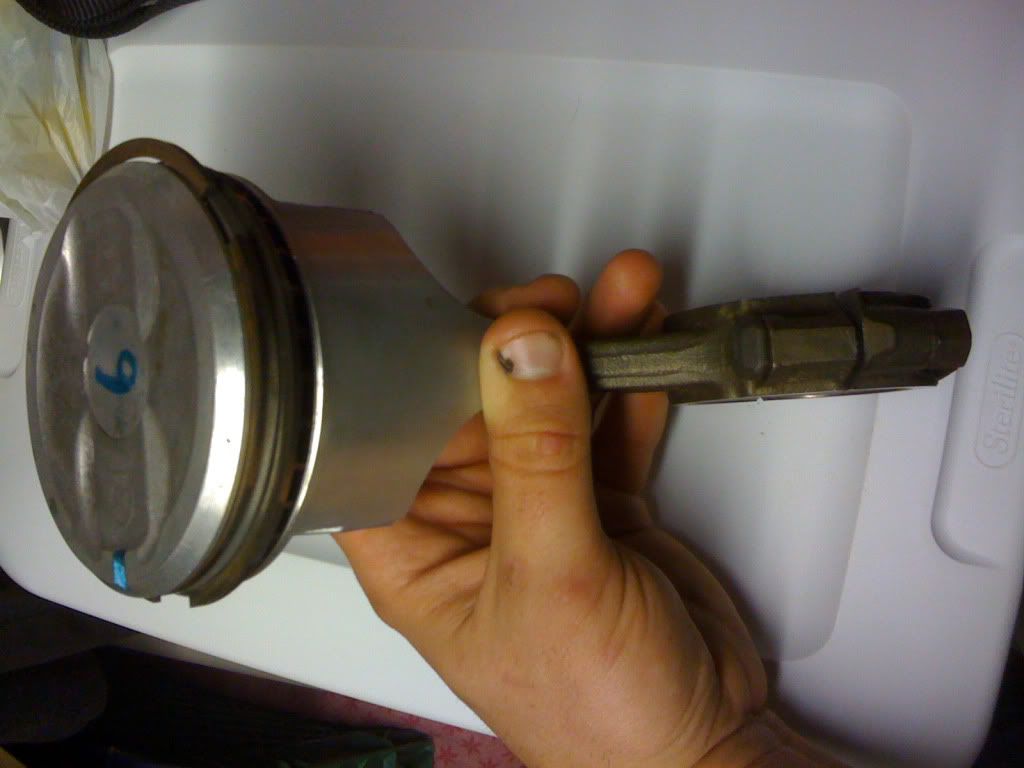

Cleaned up one piston
More crap

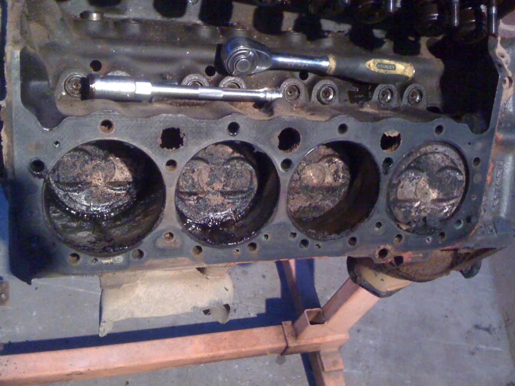

All clean and cylinder walls are good
.040 over which makes it a 357ci

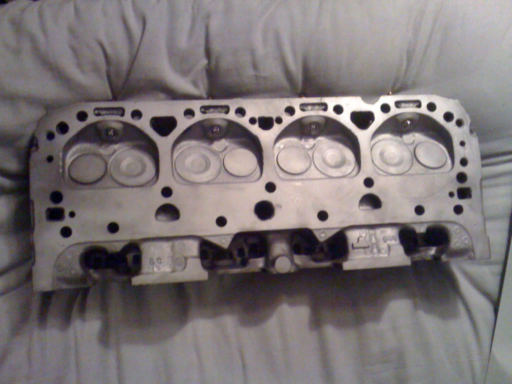

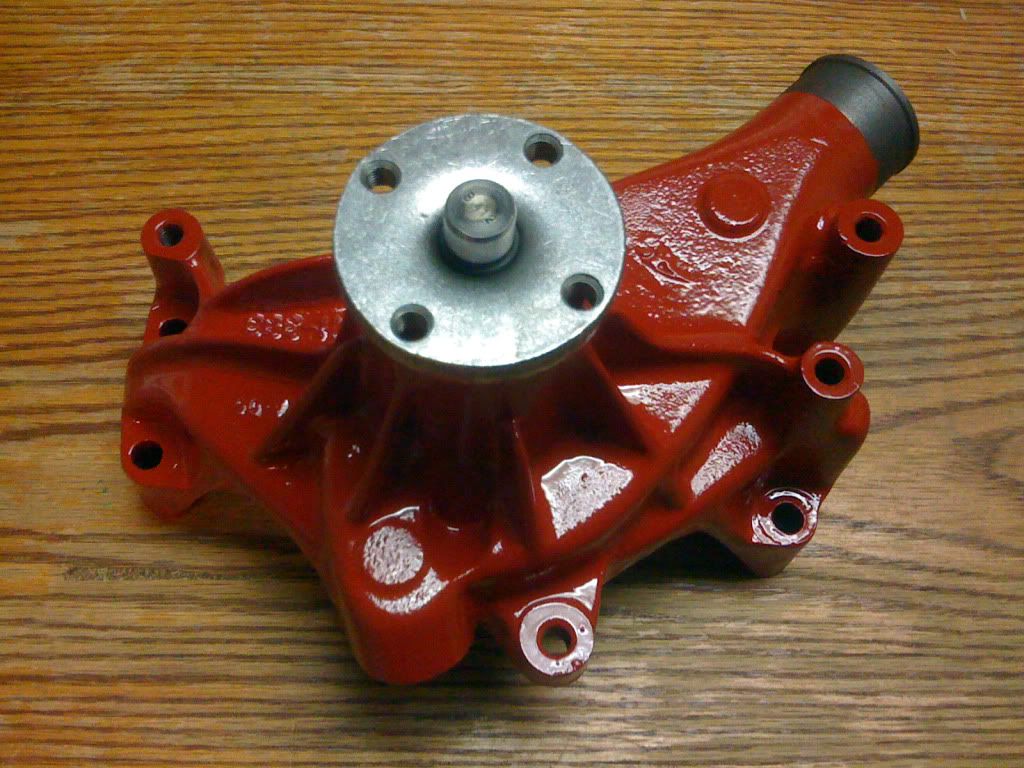

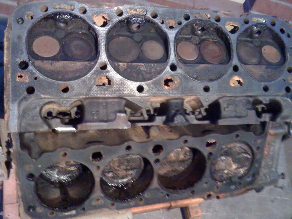

More progress today, put the engine on my stand, pulled the other head and pulled the pan and water pump.
This side looks way better then the other side
There arent and rustcicles on this head

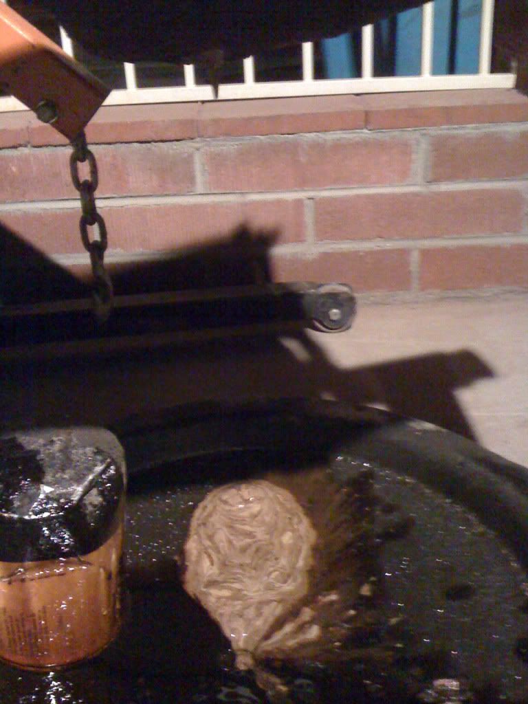

Drained the pan, yummy milk from it sitting

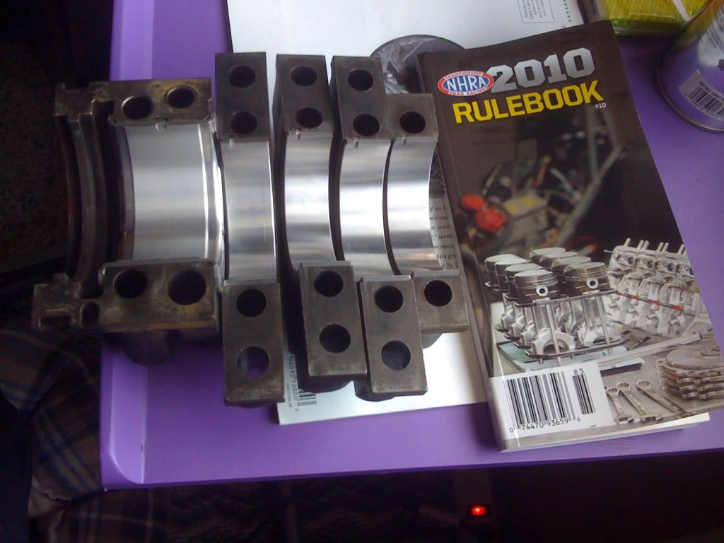

4 bolt mains was a surprise, from what ive read trucks didnt have 4 bolt mains so must be from another car

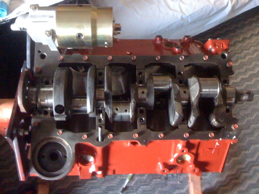

some updates

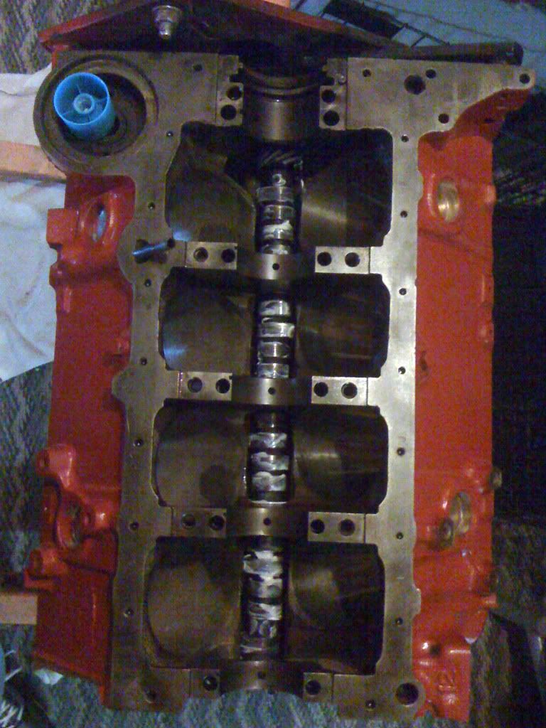

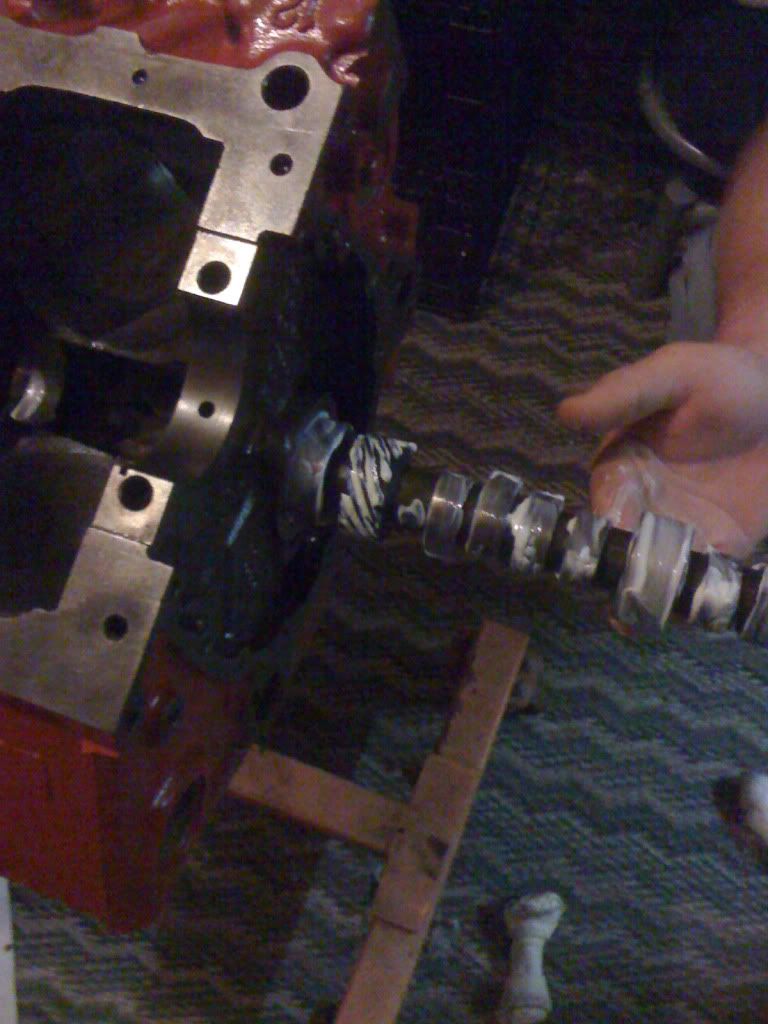

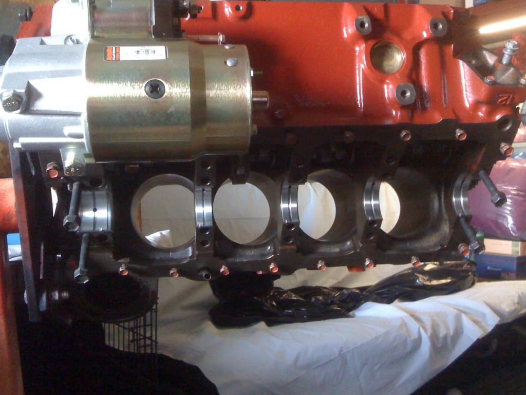

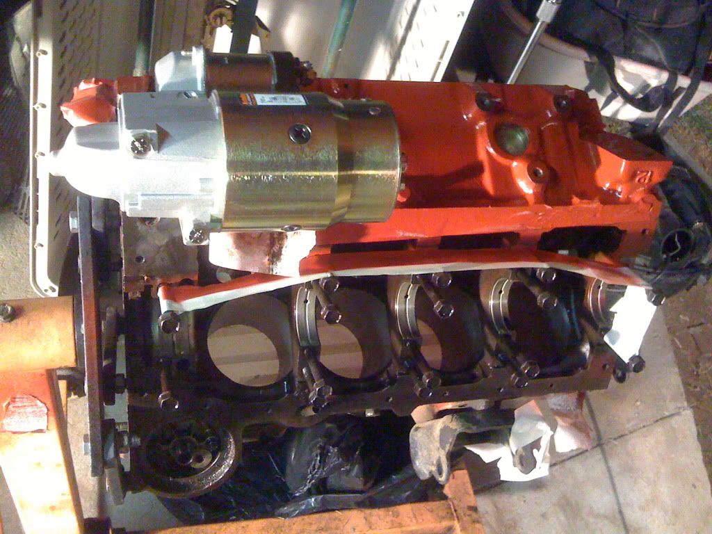

honed the block

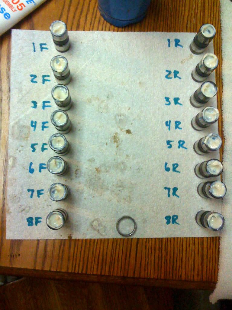

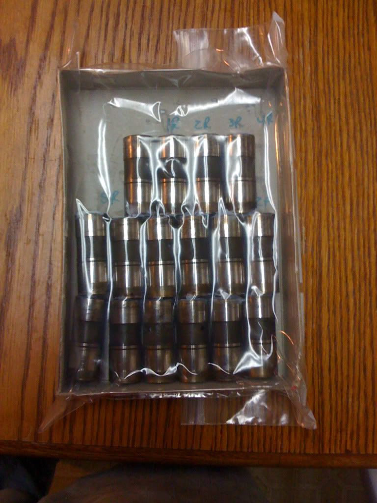

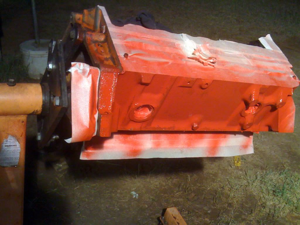

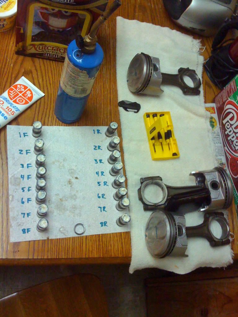

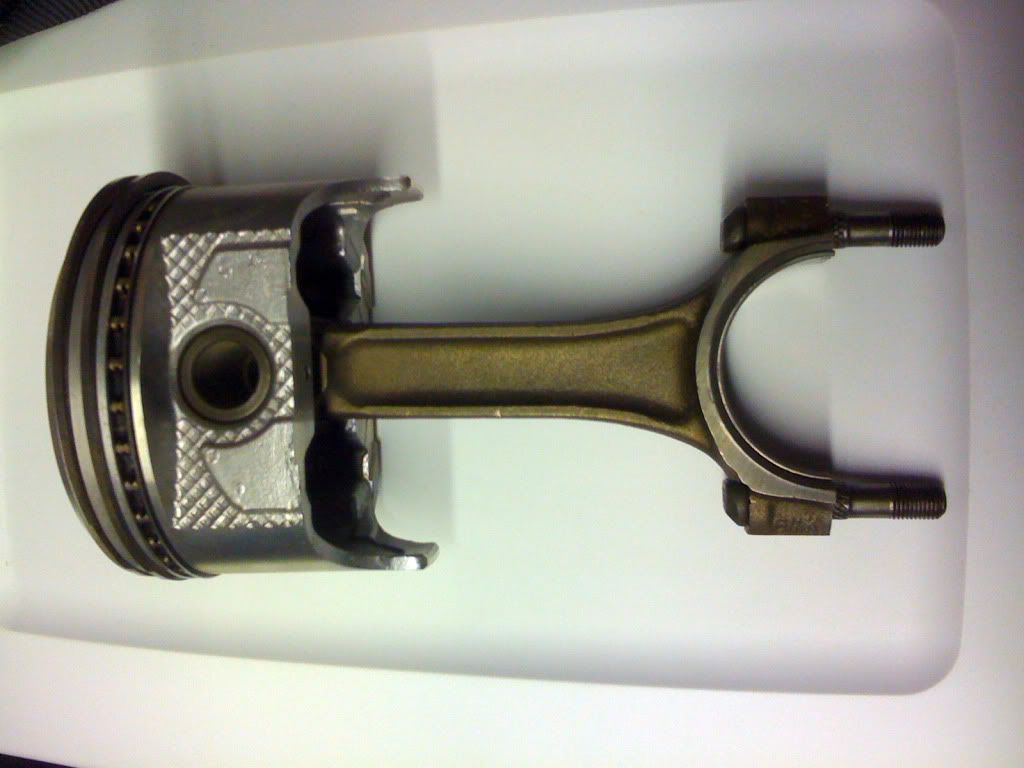

cleaned all of the pistons, rings, bearings, tappets, and caps

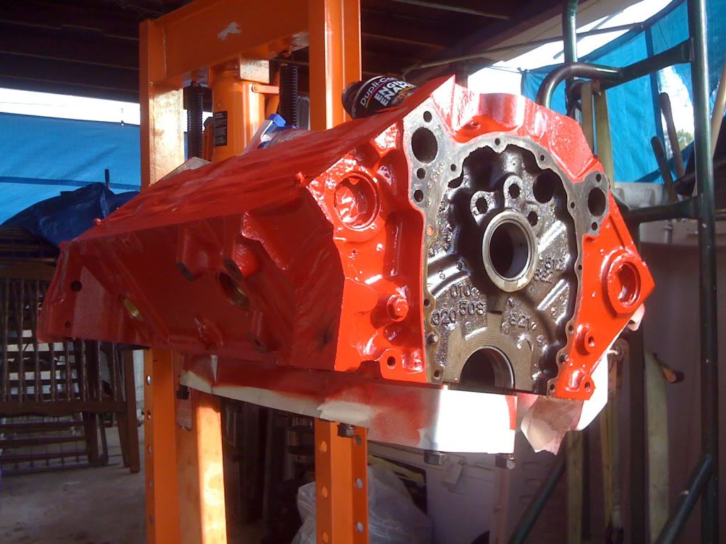

need to clean the block, crank, and cam
will post pics of the block tomorrow with daytime light

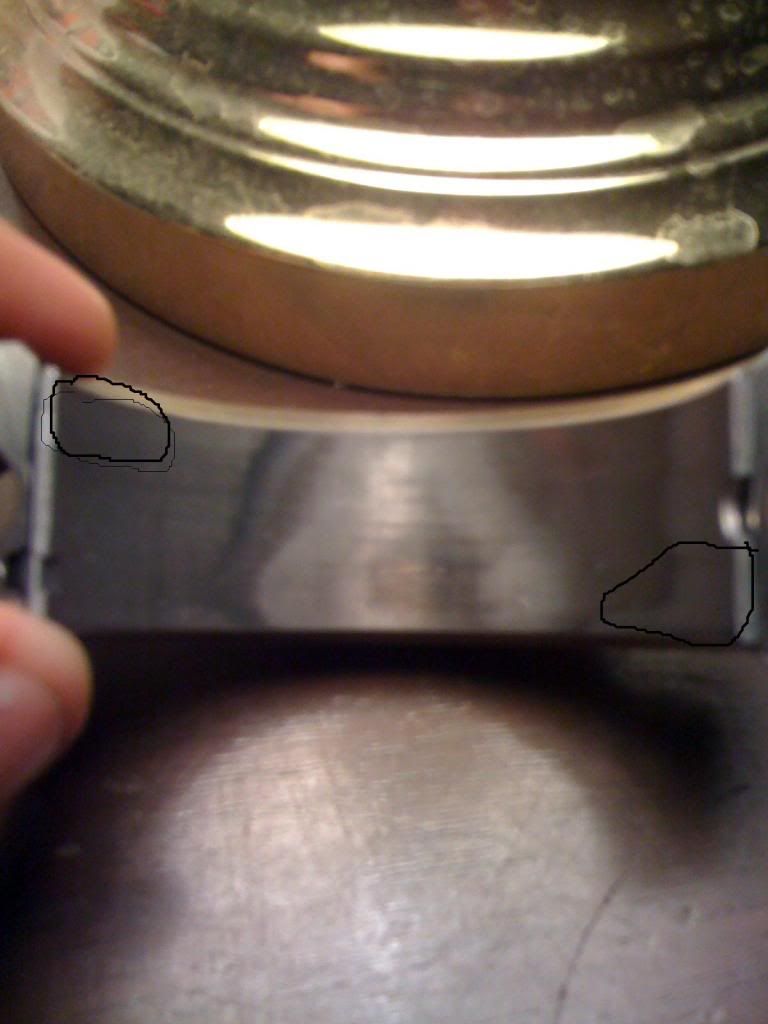

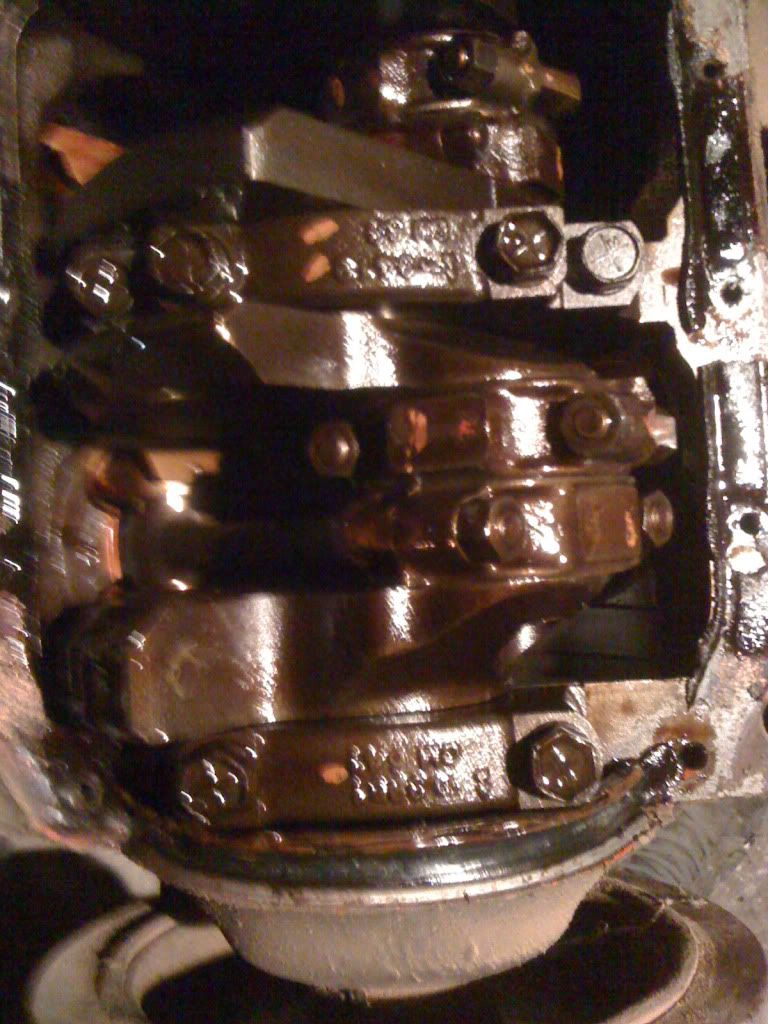

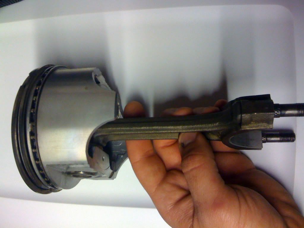

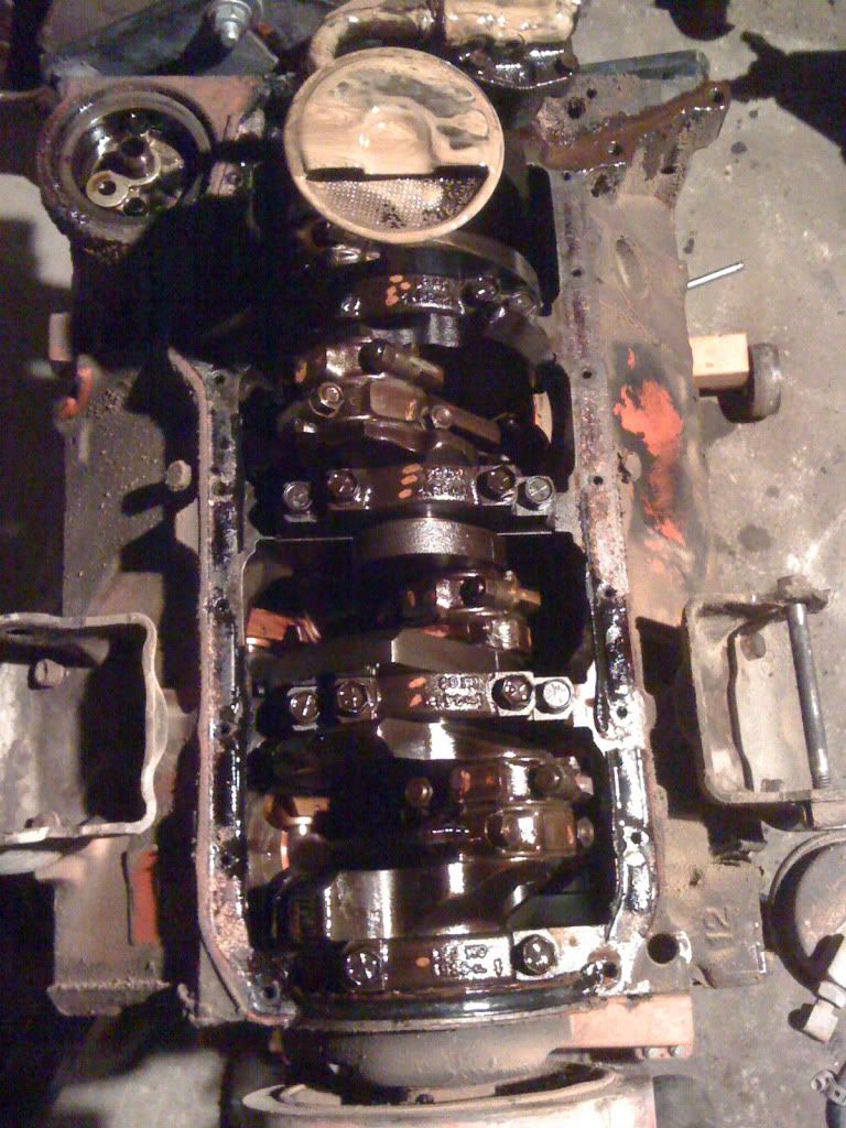

rod bearings were replaced with clevites they all have very unusual wear, most are offset corners so top left, bottom right whats that mean?
an example of all the other bearings
clean pistons

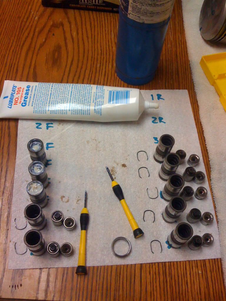

cleaning and lubing tappets

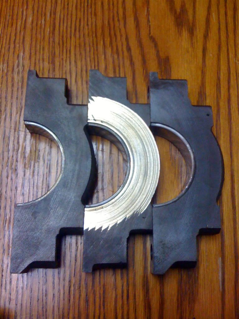

main caps, the one cap has .010 off of it, but the thrust washer looks fine. there is alot of crank play

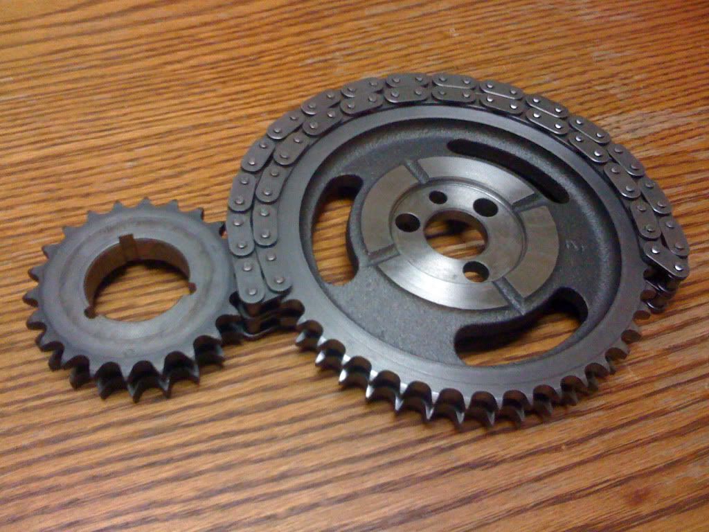

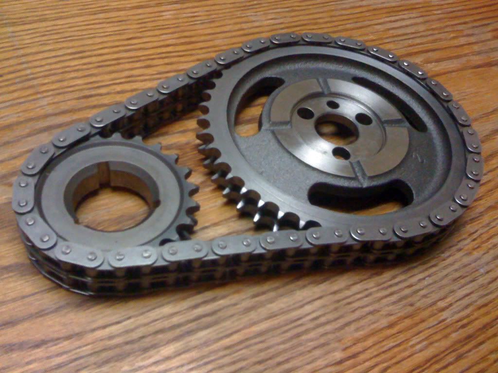

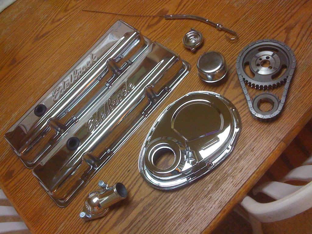

goodies double timing chain, with option of retard and advanced cam timing. and chrome stuff i picked up for cheap. all for $60 at my friends checker store

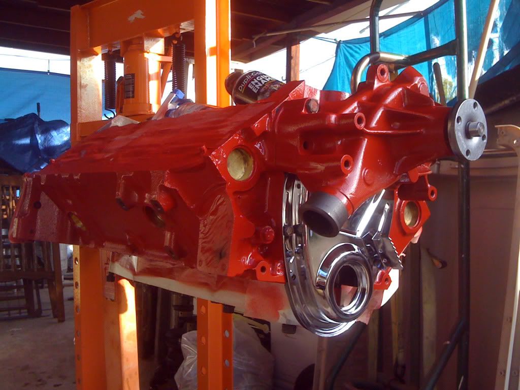

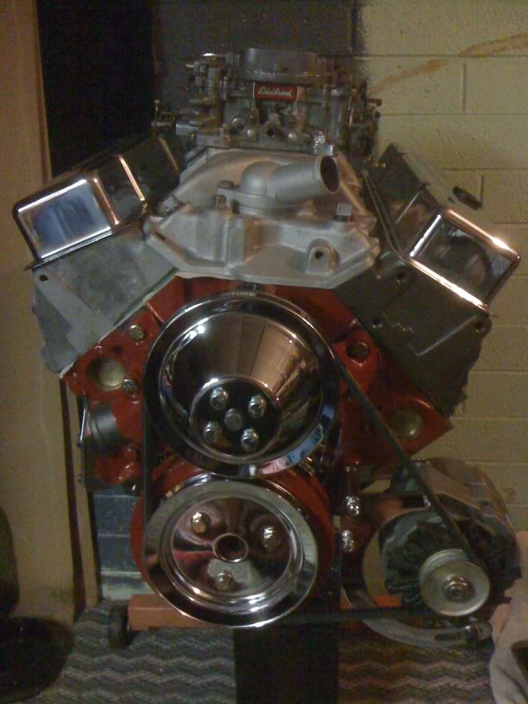

Me and albert have spent alot of time sand blasting things. And spent Christmas eve together...... ;) sorry Carlos.

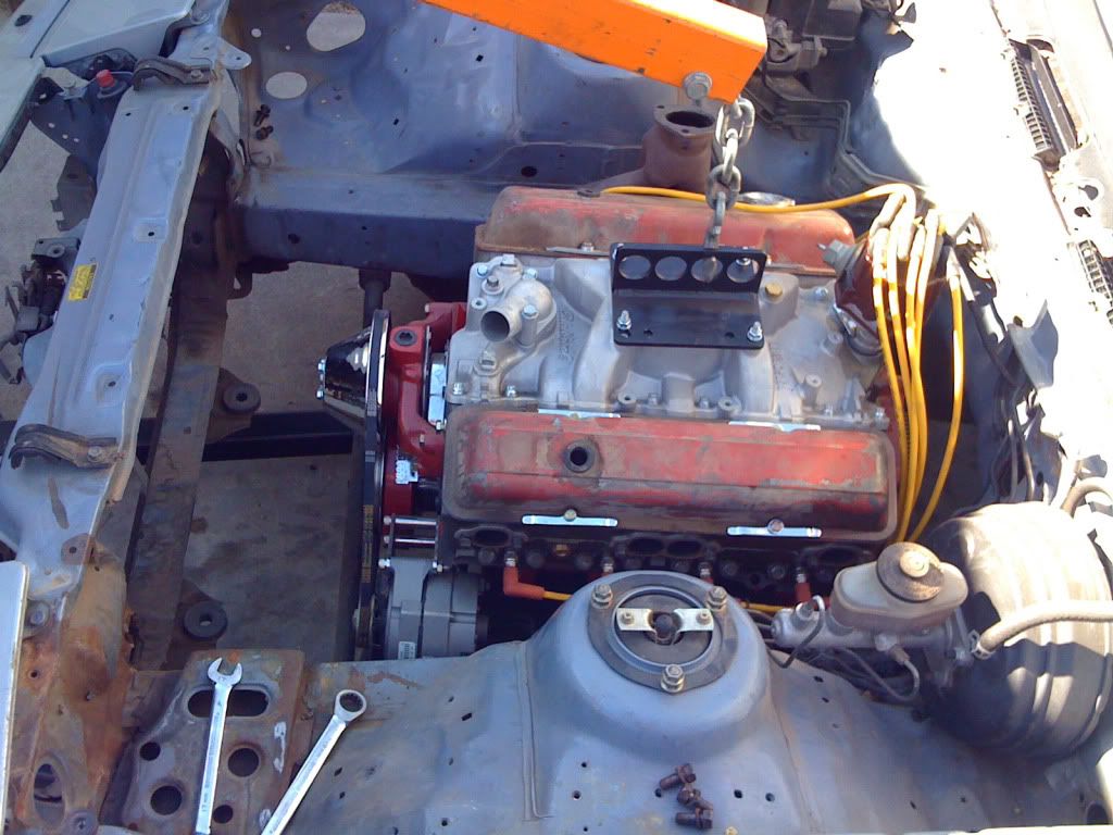

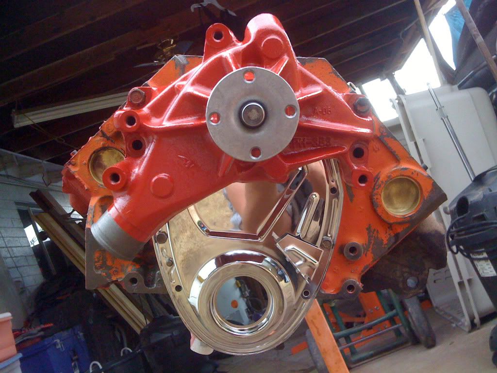

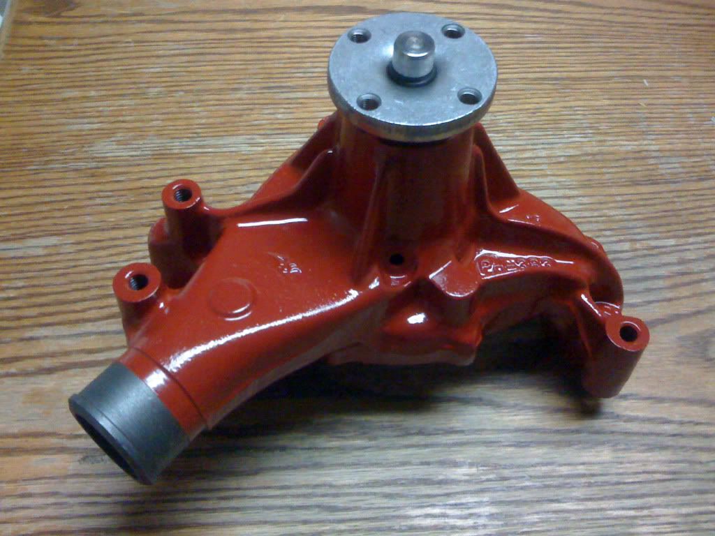

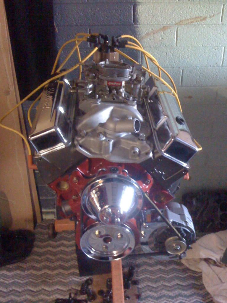

Picked up some goodies, edelbrock 600cfm carb and "permormer" intake for $100. The intakes performance is definately in the weight alone compared to the cast pos.

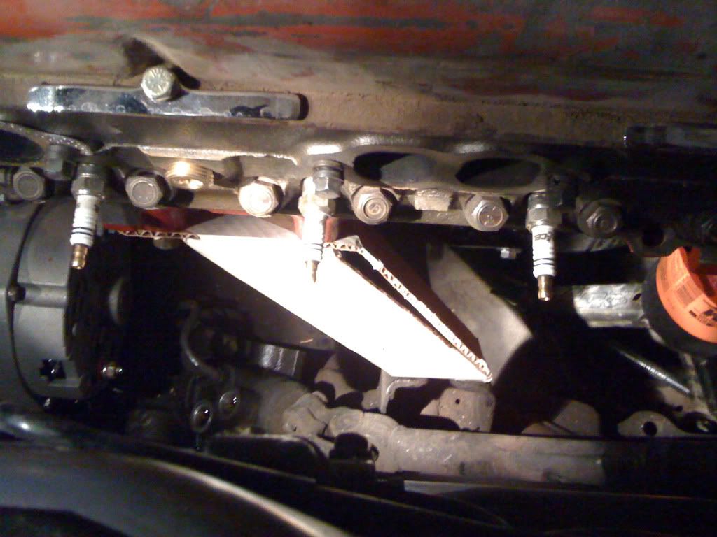

Also got and alternator relocation kit, made it down low instead of on top definately looks better, along with adjustable linkage brackets from lopers.
Ordered a oil cooler housing on eBay mated up with the cooler I picked up from Jason.

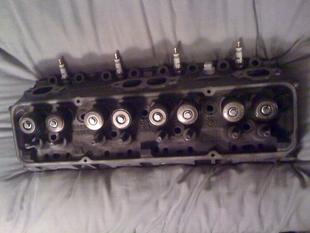

If any places were open it would be done, I just need to lap the valves but no one is open to get lapping compound till Saturday :(

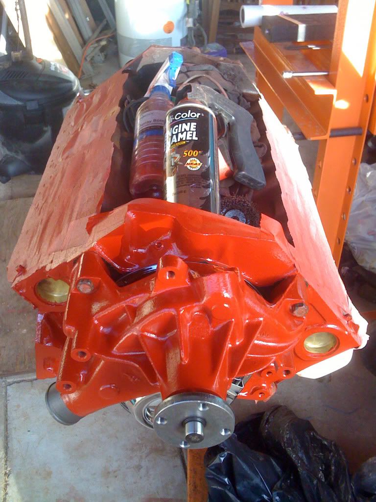

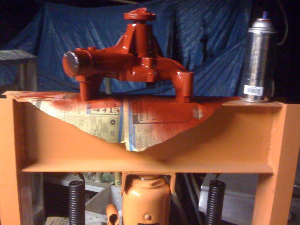

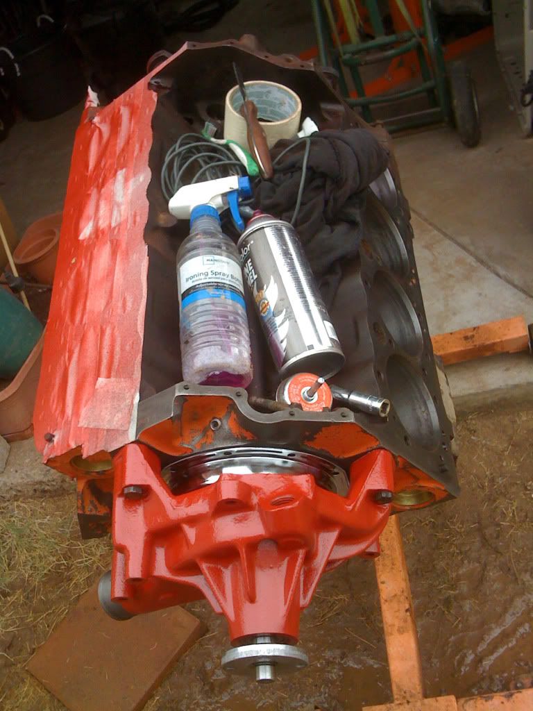

need to paint one more head.

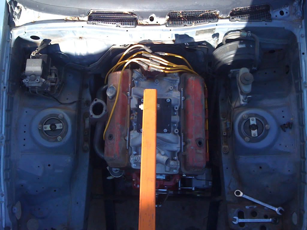

heres some videos

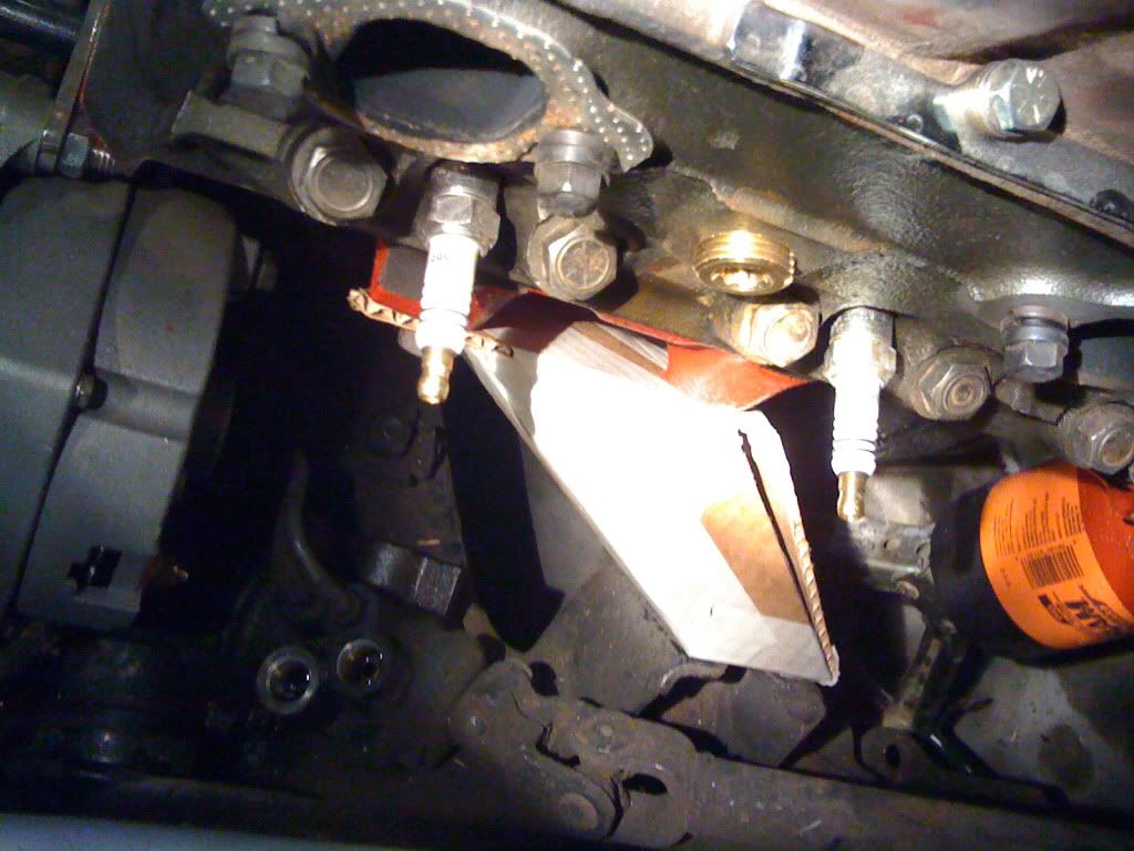

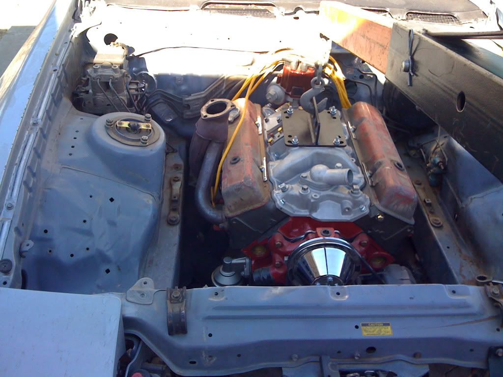

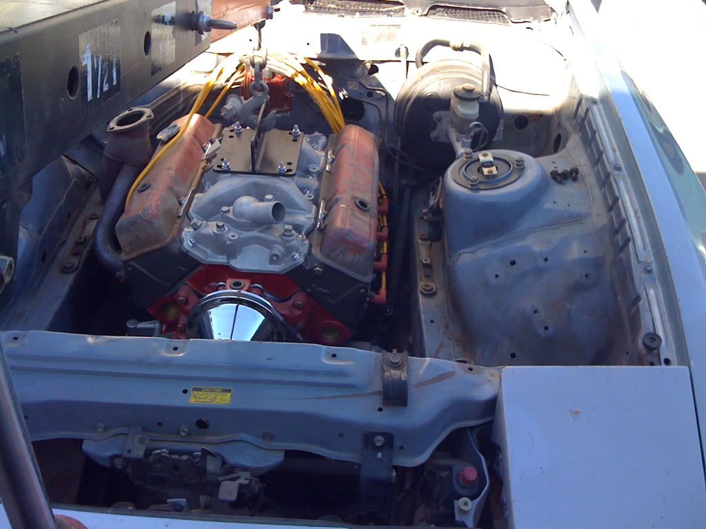

first one starting, timings not set, vacuum lines off, centrifugal advance sticking open and cyl 5 not firing.
now, everything fixed. timing at 6* advance, valves adjusted, vacuum lines hooked up, sticking advance fixed, have to fun the crappy valve covers to flip the headers up since they wont fit down with the engine cradle.

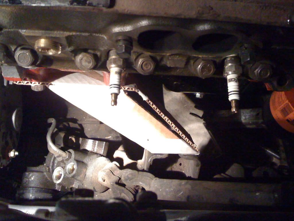

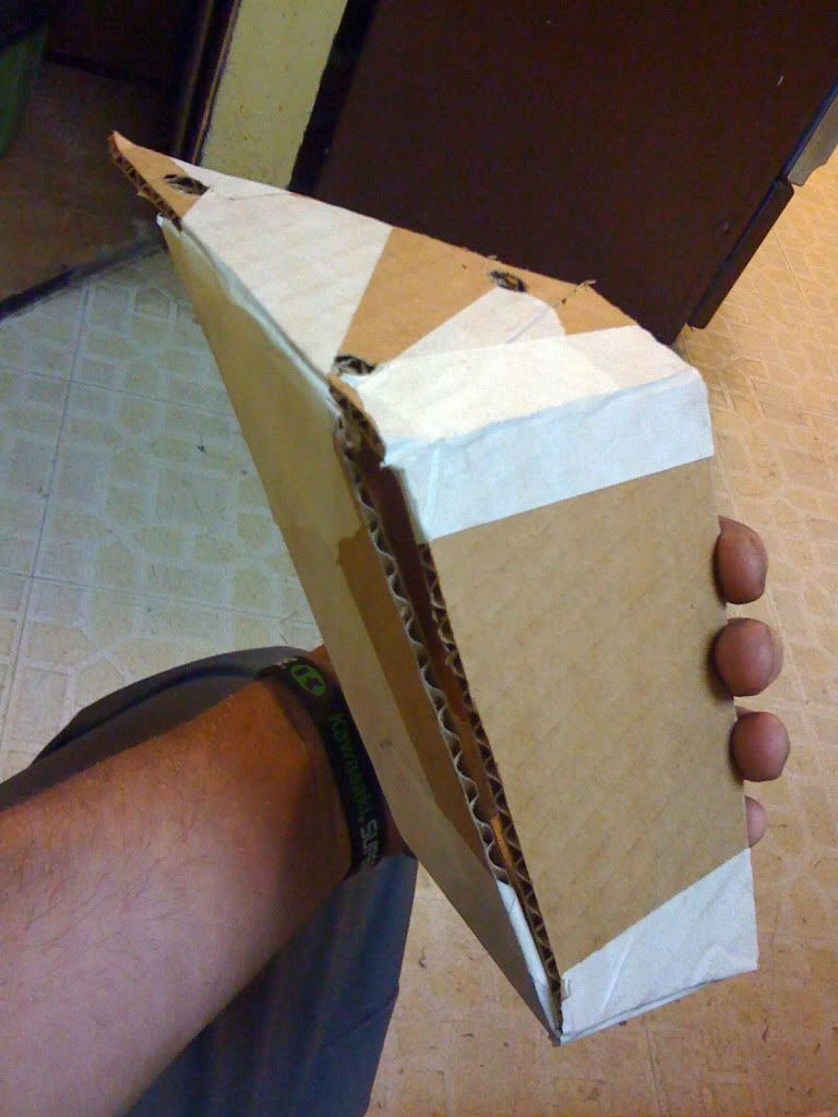

need to get headers like this, something from a newer chevy pickup ive been told.
the headers on the engine now are just to start it.
and then as far as the rest of the exhaust back, i havent decided yet. i have to choices
1. having dual 3in exhaust all the way back coming out the rear bumper
2. coming back,and then exiting in front of the rear tire

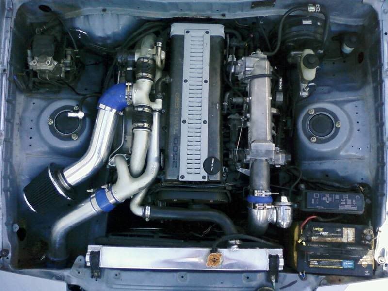

being bored and wanted to do something new since mostly everyone is doing JZ's now these days. plus it was a good deal for the motor and seemed challenging since i've only seen probably 2-3 350 swaps, and only liked one of them the others were a complete nightmare.
plus i love super clean engine bays like how my 1j was
