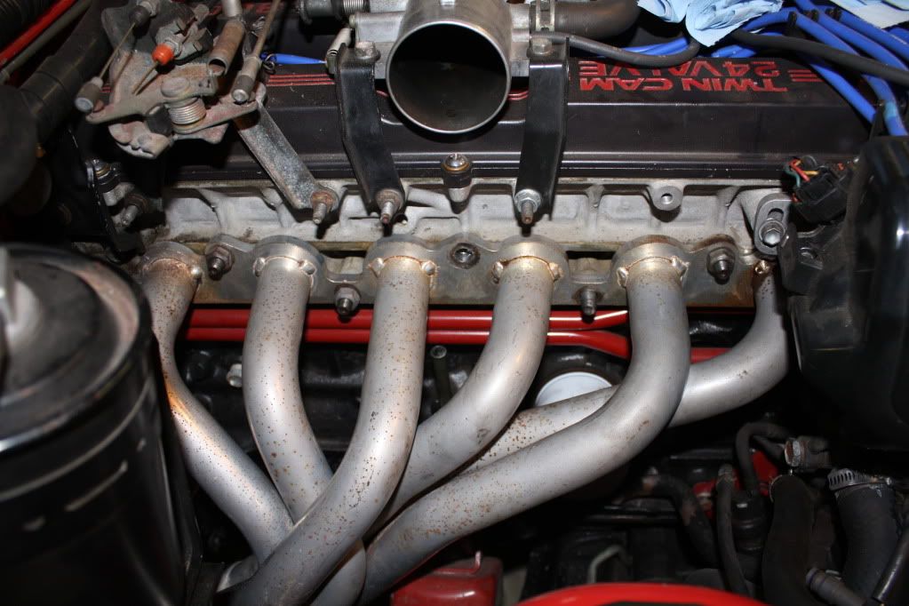

when i pulled the cast manifold off, it appeared to have a slight leak on cylinder 6. every single stud backed out of the head too, so i got those cleaned and reinstalled.

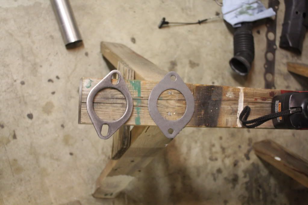

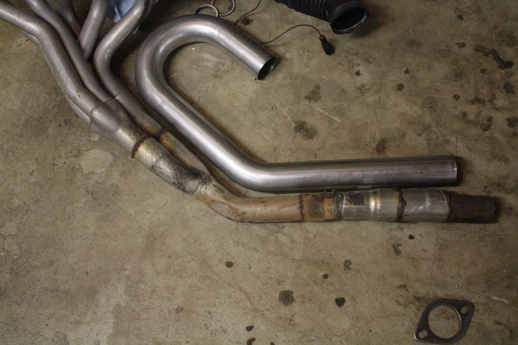

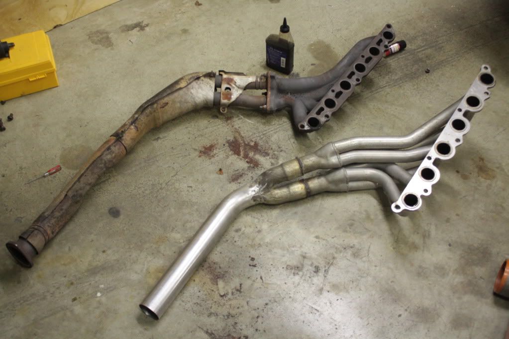

alright! more progress made tonight. found the bend that i needed and a flange/gasket and saved me a ton of time with the welder and saw :) plus it looks pretty good.

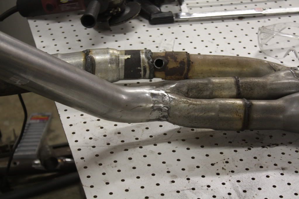

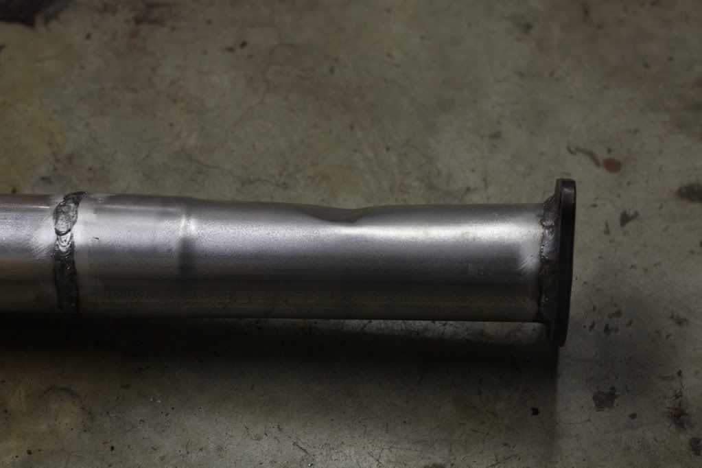

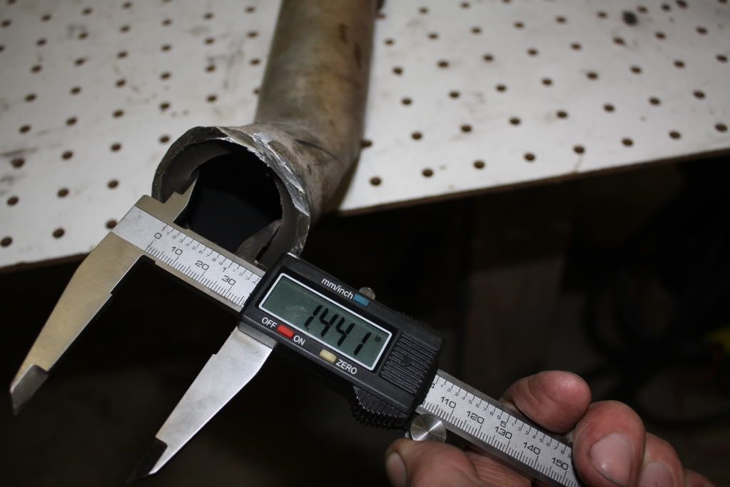

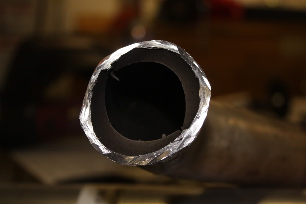

got the y pipe cut and ground, and got the holes drilled to 1/2" (and adjusted one with the die grinder). didn't get any pictures of the cut pipe, but got a laugh out of this section of the pacesetter. talk about a bottleneck!

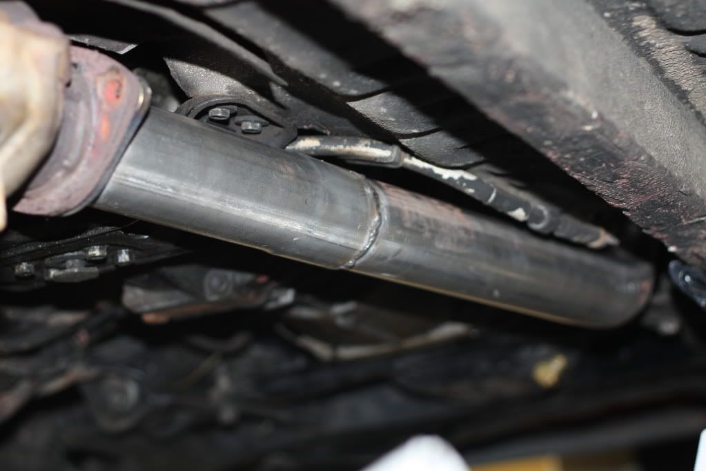

after the y pipe was cut, it got bolted up to the car for more fitting and some tack welding.

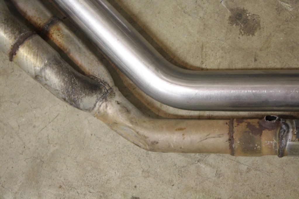

i basically got it in the ballpark and welded it up. ill be the first to admit they aren't the prettiest, but i'm just going to grind them smooth and ceramic coat the whole deal. had to close a nice size gap since i cut an odd-shaped oval.

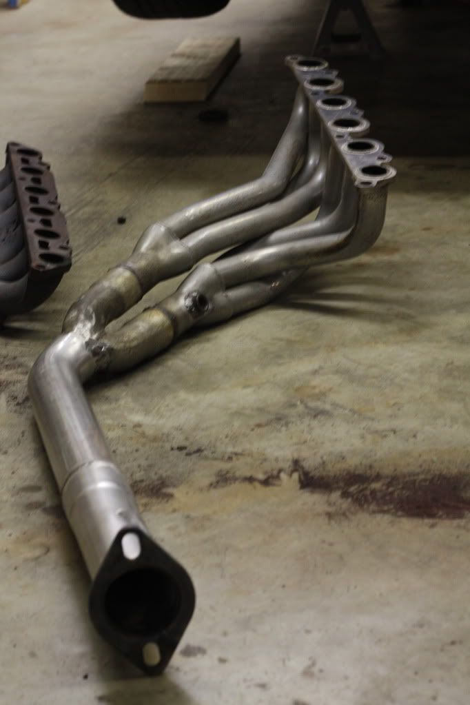

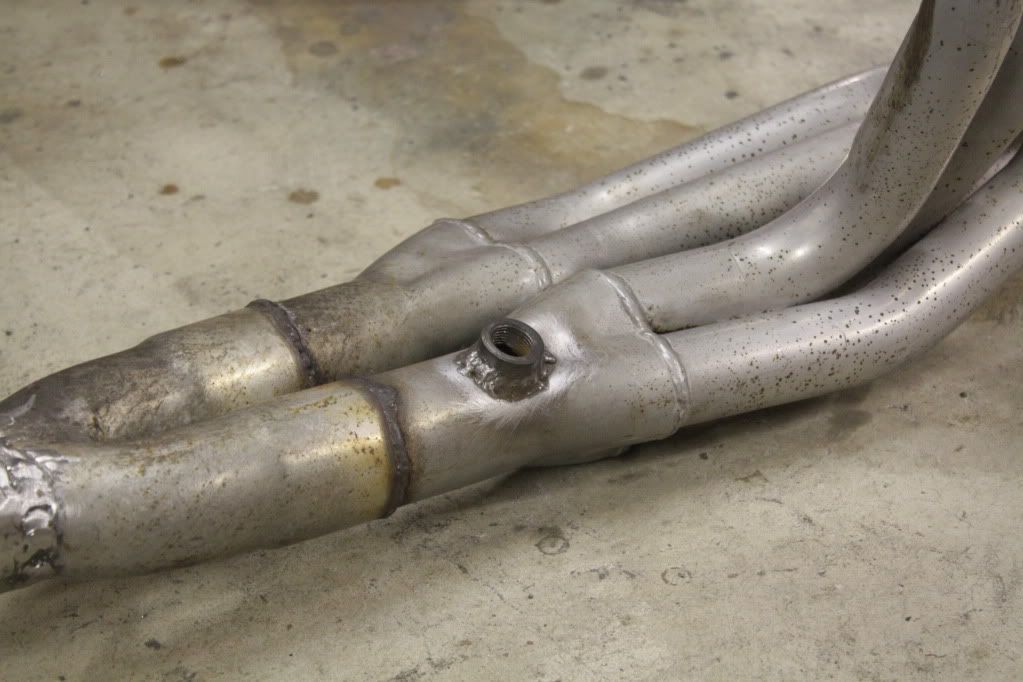

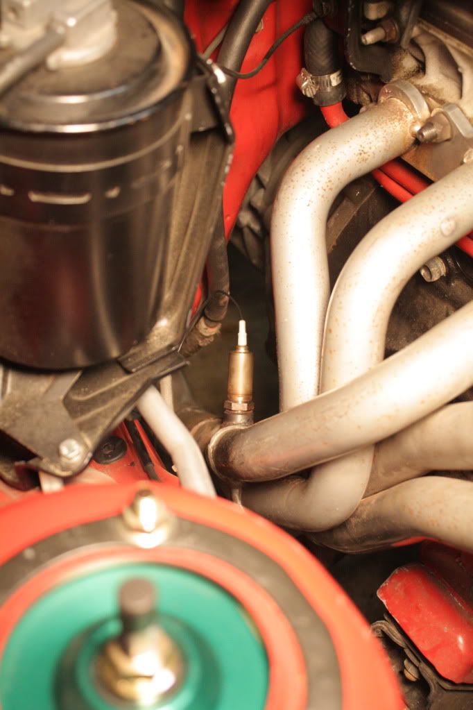

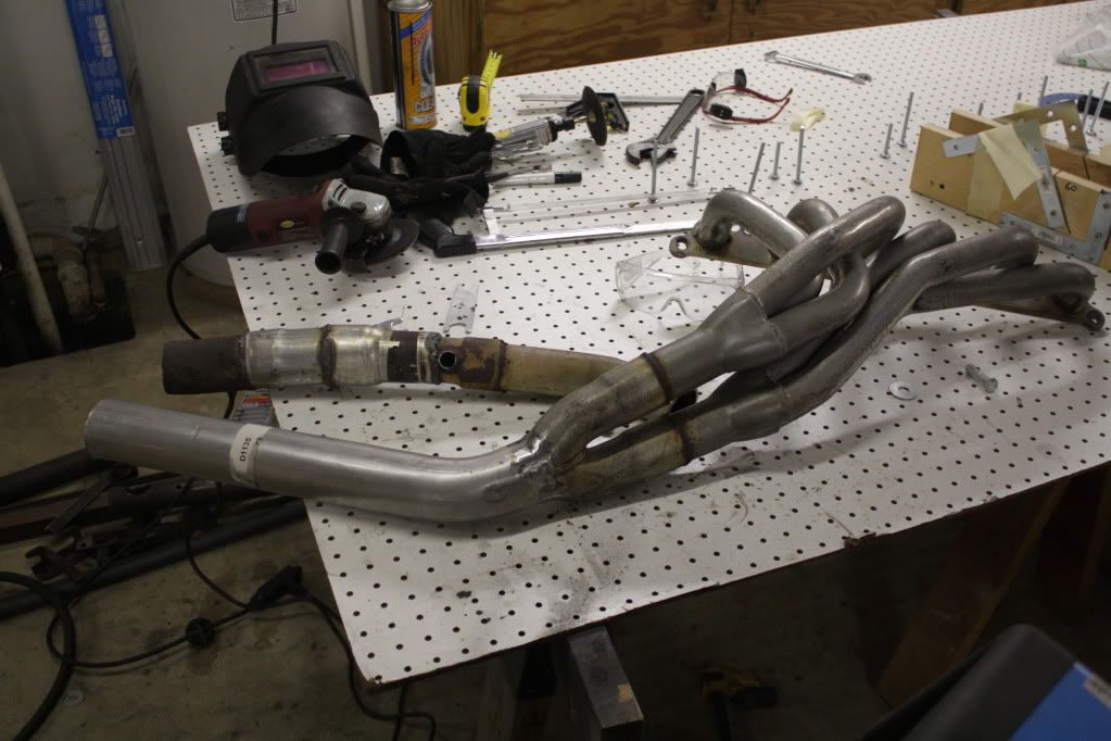

hey its done! got the oxygen sensor bung welded on yesterday, finished welding the runners to the flange yesterday and today and got the last length cut and adjusted. not happy about that last part, but it was the cleanest way to get around the trans brace.
ill grab some more pictures when i pull it off saturday for ceramic coating or wrapping.

That is a nice improvement. The only thing I probably would have done differently is to move and replace the Y-pipe. It would have been easier to buy two smaller 45's and extend the header under the floor pan and then use a prefabricated Y-pipe to merge the two pipes closer to where they originally merged together. There would be more welding involved, but at least you wouldn't have to mess with any oval pipes.
gofastgeorge
Jan 24, 2008
944
Texas
That was what I did (extend the secondary pipes),
but couldn't find a pre-made Y that I like, so I built that also.
Damn, never looked inside the Pacesetter collector,
just by looking at it I knew I didn't want it.
It is worse than I imagined :aigo:
Good Job,
May the Thunder Gods of the 7M world be with you.........
