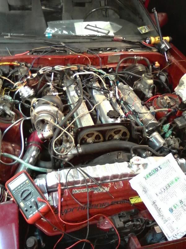

woooot my harness is done. I took the original harness and i opened it up, and took my time to inspect and resolder some parts, also rewiring what needed to be rewired and took some plugs and wires that weren't used. I put it back on the car and checked for spark and got it. So now i just need to get some loom and finishing plug things up and soldering the injector clips.
heres a pic of the mess

did some more wiring today, finished soldering the injector clips and other wires and i got some wire loom...I ran into 1 problem though, i wanted to make sure everything was fine so i spun the cps and got spark and inj. to fire but the fuel pump didnt prime like before which was weird and i couldnt figure it out, however it seemed to prime when i tried cranking the car...kinda weird, any ideas?
shouldnt be too hard to figure out though. I will get more pics of progress as soon as i can.

alright here we go i got a video but the sound isnt working for me, unless i open it on my computer through quicktime...
lets see if this works,if not anyone have any ideas?
The car isnt idling right, even though it needs to warm since theres no CSI or ISC but i can rev it and it smooths out in the upper RPM's. I'm thinking this could be caused by timing and/or i found that the spark plug wires dont snap onto the plugs, plus when i tried removing the plugs 2 of them broke, wtf...i guess i shouldnt be using Champion?
