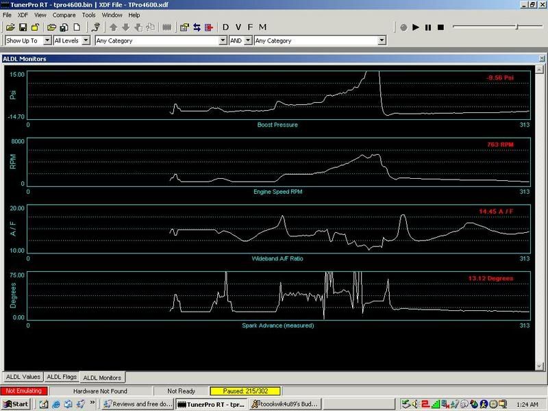

I started having the problem after I changed my TMcorrect to 0, Mike Malloy and I were comparing notes, and he was seeing 20 deg advance at high boost while I had 13, he thought that was low, and his TM correct was 0, mine was 1.29 I believe, maybe I should set it back?? I know it affects the reading at higher rpm, but no good way to set with timing light as marks on cover dont go very high. TM base =1.9

tookwik4u89 said:
Bob , any idea why my timing monitor reads like this on tuner pro?
Any chance that you forgot to upload the current bin in the maftpro to the tunerpro? from looking at the screen shot above, it looks like the bin file is for maftpro version 4.60 and I believe that you said you were using 4.65 now..

Ya, those 4600 files came with the 4.65. I set the tm correct back to 1.27, but havent been able to try it, due to slick roads. Hopefully this afternoon.
