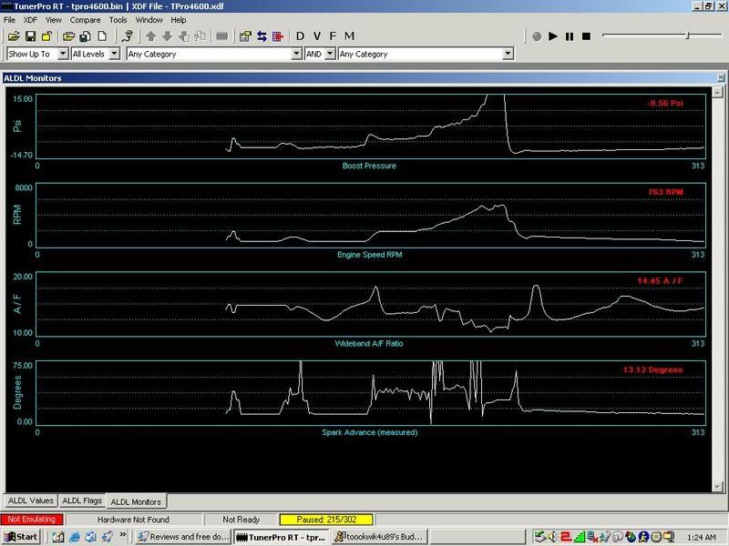

Bob , any idea why my timing monitor reads like this on tuner pro?
turbobob
Aug 15, 2005
196
Near Detroit
Perhaps a software booboo......... let me dig into it. You did clip the correct resistor
in the Pro.....?
Give me your settings (TM base, and TM correct) and your MAFT Pro version.
Make sure your input frequency looks stable...... (in tunerpro)
Bob
