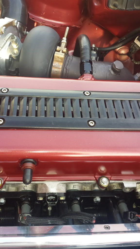

525gte
Sep 19, 2011
450
hoquiam
tErbo b00st;2012109 said:
Yea, I know that is a bit rich down low, but I'm hesitant to pull much more fuel due to the timing increase. Maybe I will try and play around with my midrange "tune" a bit more.
Not sure on the sizing tbh. There is very limited information on these turbos. All I know is they are K26, with K26 exhaust housing. with that said, I believe there are several different sizes of K26.
Tell me more about this PCV, I'm not clear. The valve cover hose on the exhaust side is dumped to the ground, while the one on the intake manifold side has the PCV valve with the short rubber hose going to the intake manifold. Is that not correct? How should I be running these? I know I "should" have a catch can. So can someone school me on the correct way to route this with and without a catch can? I will get a catch can eventually, but I have some other expenses I need to address first, and would like to fix this ASAP.
Here is what I did. The pic is capped. Than the other side is running to a catch can and pulling vacuum pre turbo on the Intake pipe
