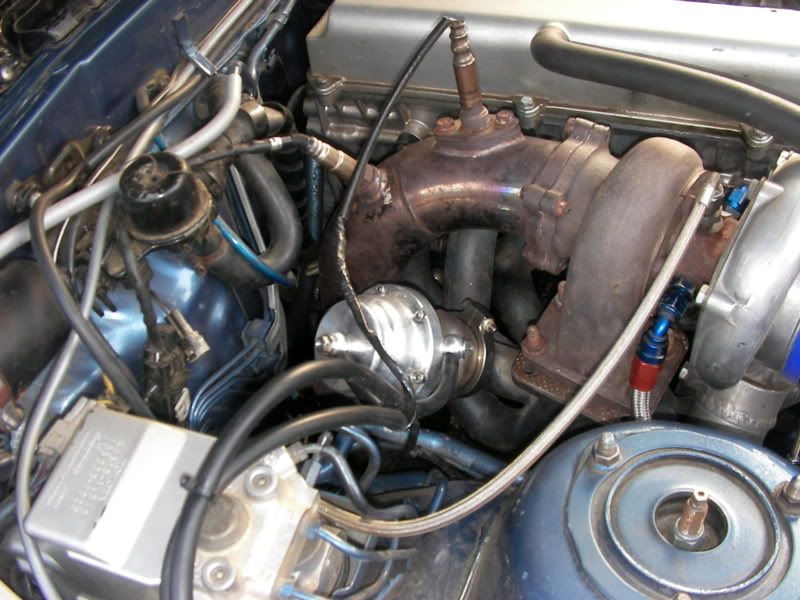

I don't really know what type of picture you need of the manifold, but it's harder to get too than I thought. Here is one that I took just to post one, but if it's something else you need, let me know. The manifold is a t4 and my turbo is a t3, but it still seals up perfectly. It hasn't got any exhaust leaks anywhere.

I need some explanation sir. I didn't design the manifold or the wastegate, so what are you telling me to do?
