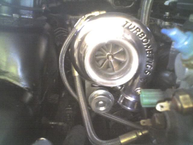

GrimJack;1286996 said:
Not sure exactly what you mean here - the turbonetics bolts right up to the exhaust manifold, downpipe, accordian pipe, and the intercooler pipe to the intercooler. The only bits that don't are the oil lines.
I'm referring to where the lower intercooler piping hooks up. The ct26 compressor outlet is angled straight down.(90*)
In the pics posted previously the turbonetics compressor oulet was angled differently.
Do you know what I mean?
Are the other bolt on turbos angled like this?
blk92suprat
J Zizzle
Jul 6, 2008
456
USA
GrimJack;1287193 said:
Oh, that. It's adjustable on virtually everything that isn't a CT - you can point it any way you want. :)
Thats good to hear...I'm guessing by the giant center c-clip?
The Turbonetics unit is held on with 6 bolts that hold down 3 little brackets. You loosen the bolts and it will slide around nicely.
You can see the bolts / brackets in this photo:
PS: You can clock the exhaust housing any way you want by doing the same thing with the bolts that hold it on.
MK3Brent
Very expensive....
Aug 1, 2005
2,878
Greensboro and Greenville NC
[thumb]http://idriders.com/Supras/IMG_2559a.JPG[/thumb]
As long as your wastegate actuator is lined up as well.
