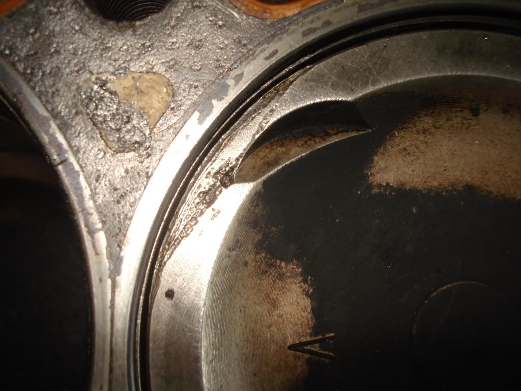

Well finally decided to tear the 7m apart due to a blown head gasket. Here's what I found :
Looks pretty clean considering I never rebuilt it before.
Melted piston?

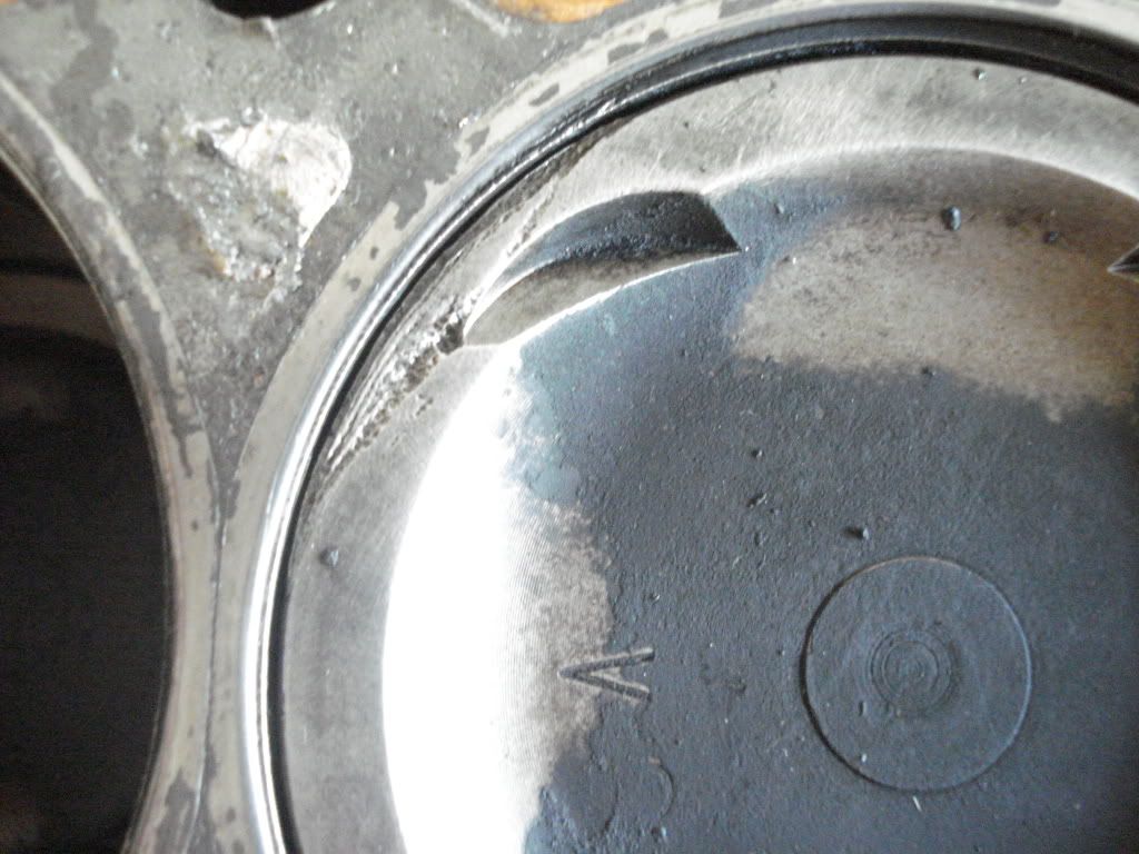

Here's another shot of it in different lighting.

Looks more like corrosion where coolant leaked into the cylinder. Is this where the BHG occurred?

Not too sure if thats where the BHG occured. When I took the head off it seemed as if it was not properly torqued. There wasn't any sign of the gasket falling apart. I don't know though. I'll put up more pictures later.

That looks more like impact damage than corrosion to me.
It definitely doesn't look like the piston *I* burned. That was a smooth radius with a rough texture on the edge of the piston and valve cutout.

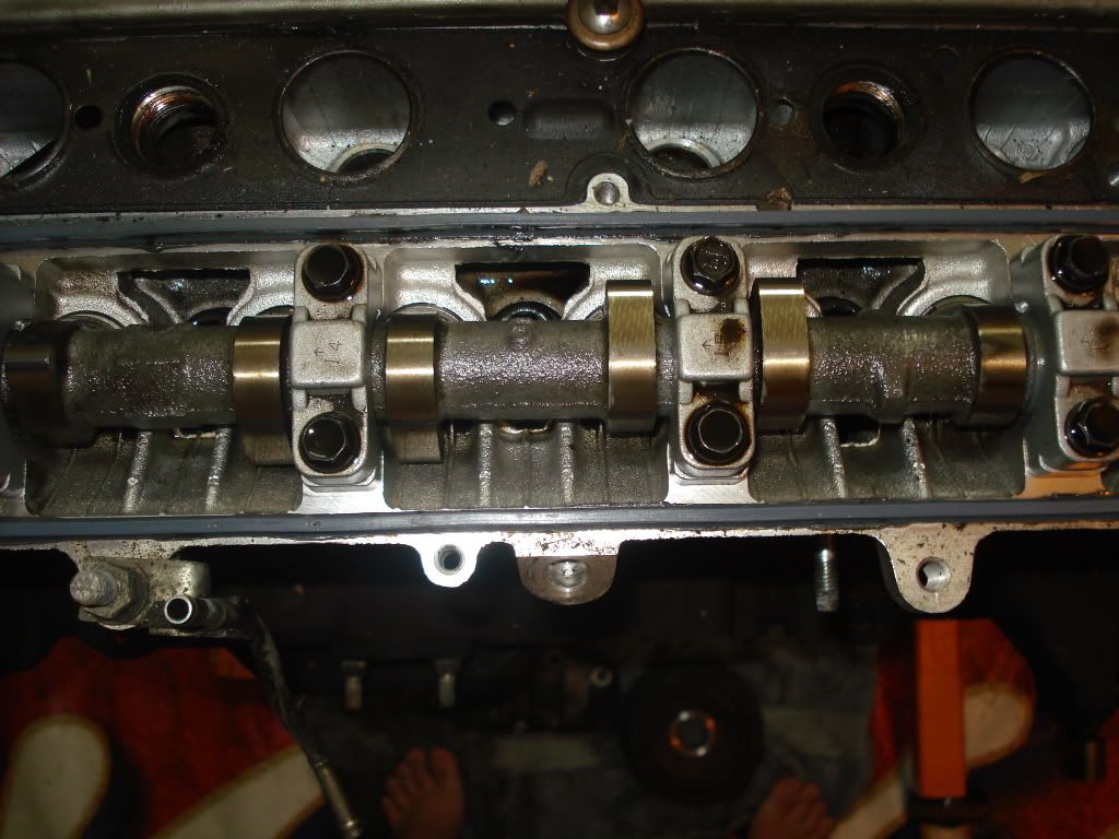

And dude, put on shoes. Steel toes in the garage will make you a MUCH happier guy in your old age. If I hadn't been wearing them, there would literally be no toes on my right foot anymore.
