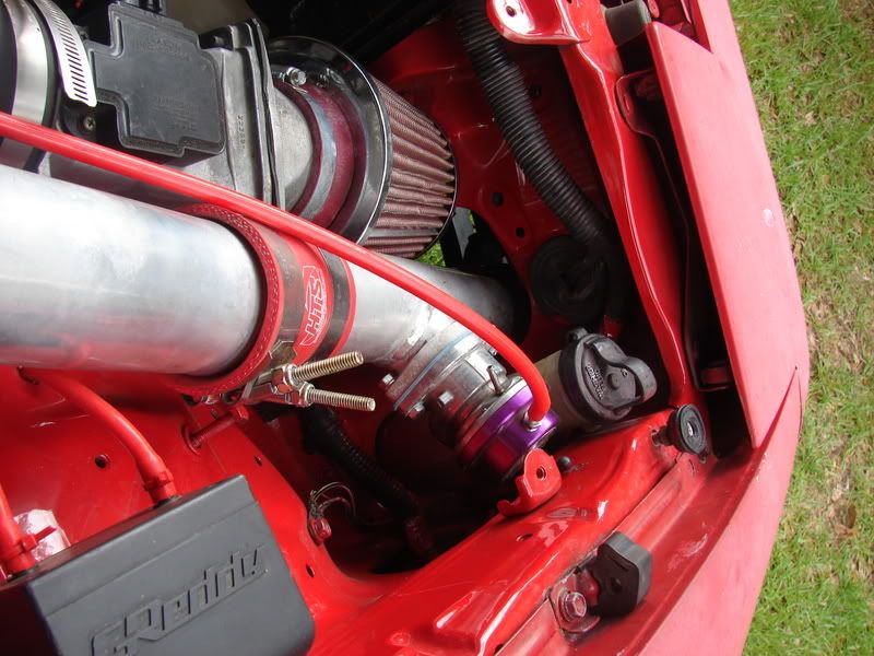

ForcedTorque
Join the 92 Owners Group
Jul 11, 2005
6,099
58
This is my Lexus with a $10 Driftmotion filter. It does touch the front panel, but is not too bad.
