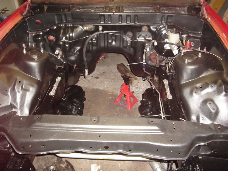

i got a little ambition to play with my car even though fund's are low.my sister bought me a heater for my garage for christmas,so it's a little better in there.i started putting my engine bay back together,but still need a new rack & pinion before the motor drop in.i'm also waiting on my spec clutch from titan,so motor and tran's can drop together.here's where the 2j will sit

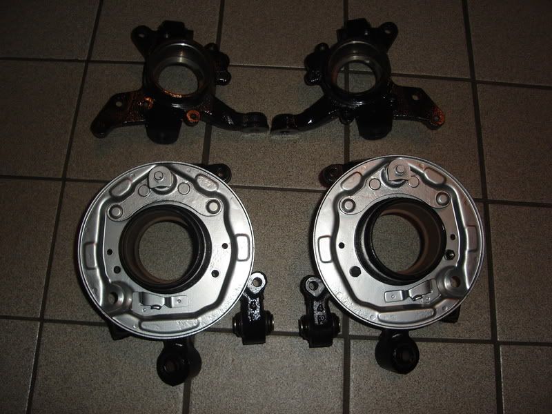

i also powder coated the hub carrier's.you can see the pit's on the backing plate's how rusty these part's were

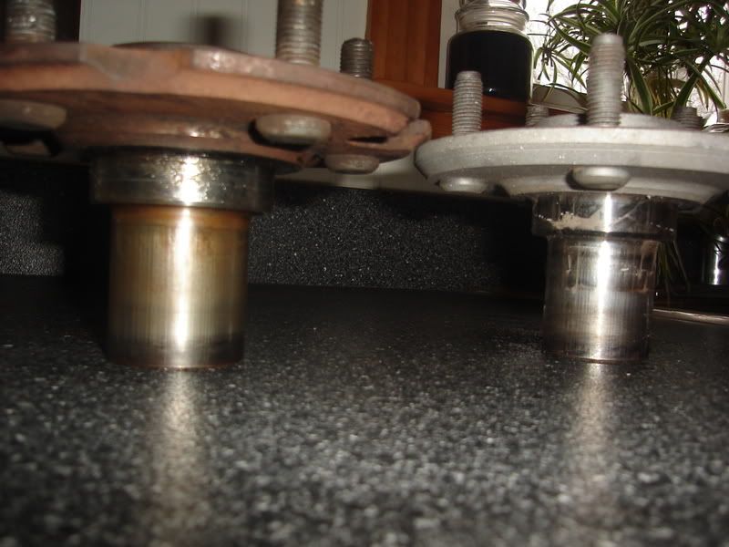

you can see my rear backing plate's don't have dust sheild's.this is because i'm going to be using mkIV rotor's and caliper's out back.i'm going to be using the mkIV hubs also.here is a pic of the mkIV hub's on the side of the mkIII.the rusty one's are mkIII.

Heh, so I guess I'm not the only one using MKIV hubs. I haven't installed them yet but I picked them up because I figured that'd be the easiest way to get the rotors hubcentric when I swap to the MKIV rear calipers/rotors.

i tried the mkIII axle's in the mkIV hub and relized the spline's were the same.then i pressed the mkIV hub out of there carrier and did some measuring.i haven't pressed mine in yet either,still need to order the bearing's.i did buy jake's kit to use the mkIV brake's also,but figured this would be a better alternative to the shim's
