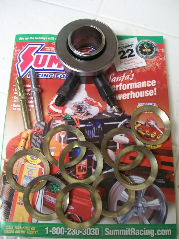

there's a factory hydraulic throwout? Then why isn't everyone else doing this?
Beats me?
The bearing retainer is ~$50 from GM parts direct, part # 89048231.
The hydraulic throw out bearing is ~$50 used on carpart.com Any bearing from a Chevy colorado will bolt on.

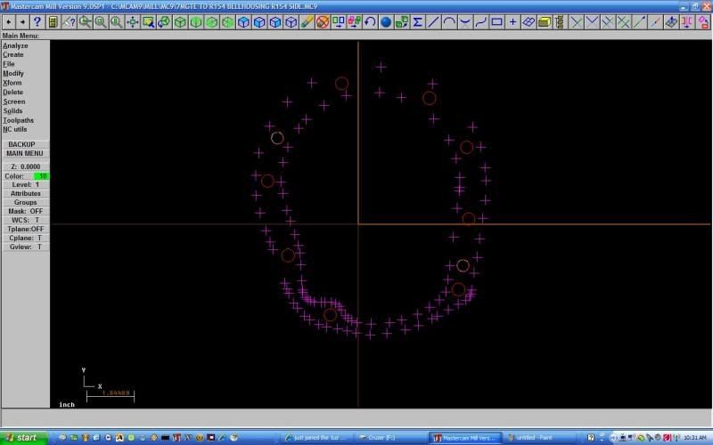

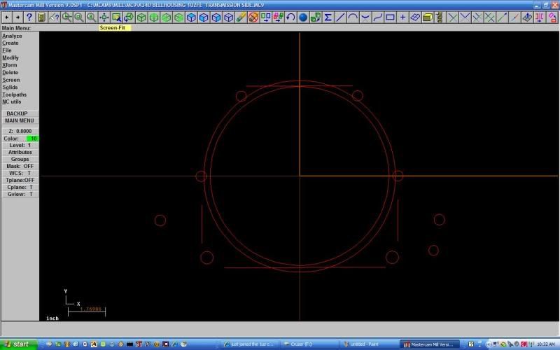

I already purchased the plans, But I'm going to be making some moderate changes to their plate. Partially to accomodate the specific hydraulic throwout that I'm thinking of using. (more info wil come later)

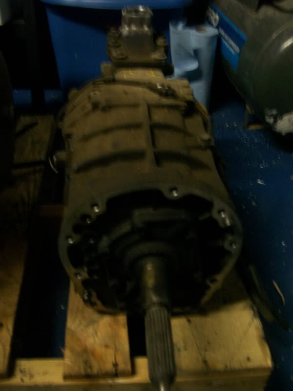

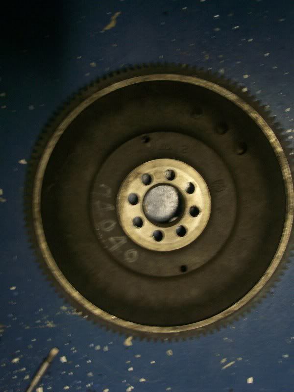

I got the R154 today, The guy also threw in a mr2 flywheel. I read somewhere that people are modifying them for this application so I'm hoping I can find out more info about what has to been done to make them work. I might also figure this out on my own tomarrow when I get everything seperated.
Hmm. I might look into this if I have time.

Here's the filthy r154 I scored for 80$
Here's the MR2 Flywheel, I need to take pics of the 7m one so you guys can see the difference. The mr2 flywheel looks just like a lightened 7m flywheel...
I'll have some screenshots of my adaptor plate file in the next day or two.

if you didnt have every CNC machine that i could think of, i would question the elongated bolt holes... but i still do question it... especially with what i know your planning.
