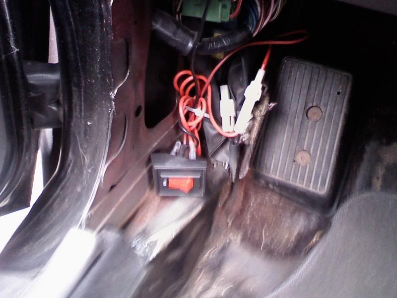

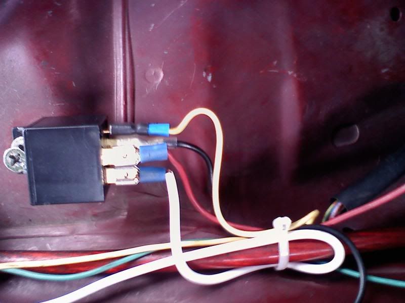

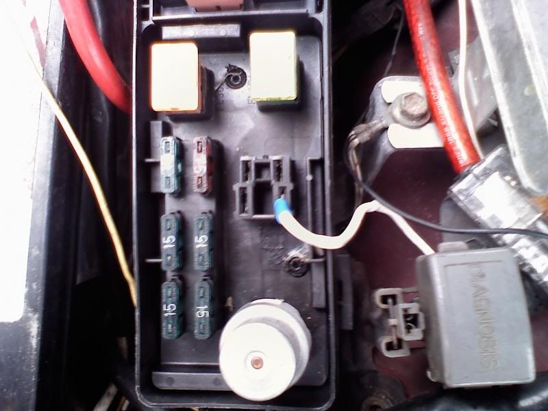

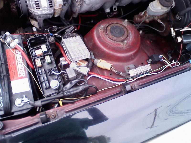

Sorry it took so long to get pics it has been raining like everyday and the nice days i've been working :3d_frown:. Anyways, here they are!
Im using a 12V 30A relay.
Thats where you want the 12v to go when you turn the switch. In my case i leave the extra headlight switch i added always on. The headlights stay on even when the motors are switched to off through the stock switches.
12V 30A Relay
and the extra switch and where i put it.
Hope these help! :)

I know I know. I'm swapping to a yellow harness i just need the ECU that's why it's like that. So all that wiring and junk is going to tossed.
