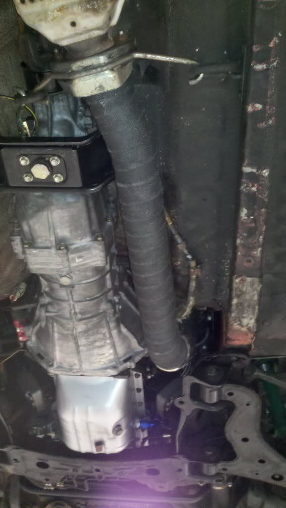

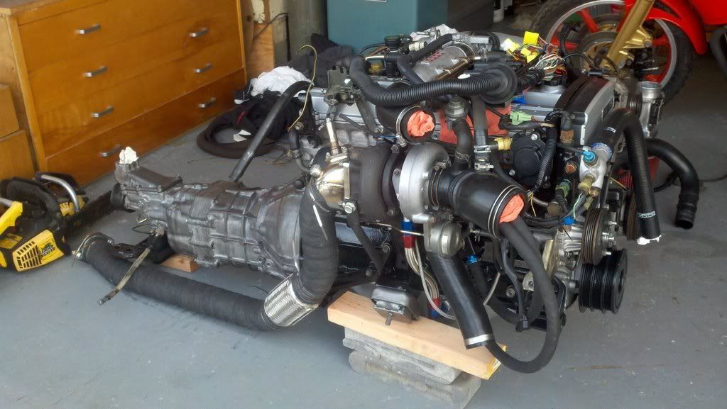

I'm using an eBay one personally. But I am also using a external wastegate. Removed the flange on the dp used the wastegate tube as the new external dump tube. Welded on a v -band for the t-70. At the straight section I'm going to be welding a electric cut off valve then as for the flex section I will use my pre-existing 3" pipe from my exhaust system :) all leaks are solved. Oh btw the wideband location sucks on the eBay dp. They sit right on the firewall
