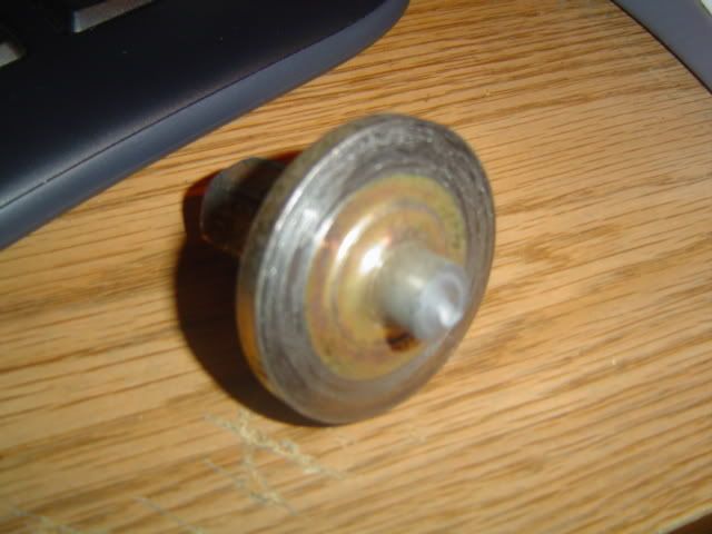

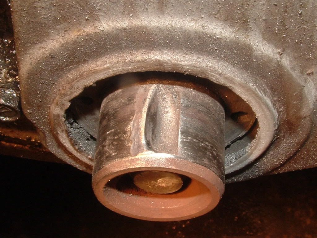

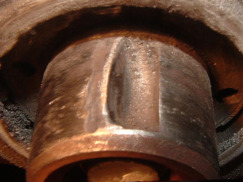

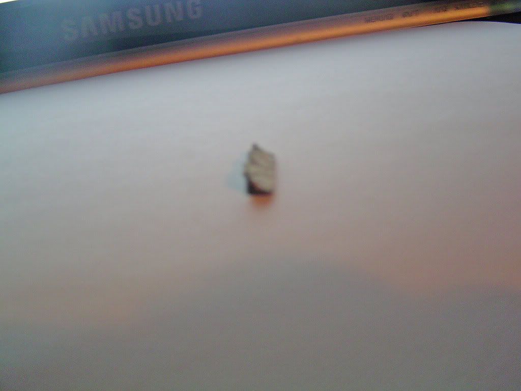

Ok well here's an update. Ok so the crank bolt was so tight that it broke off. Also as u can see how the crank looks... the pulley is slightly damaged so i got a new one (used) that's in good shape. Tell me what u think and i wanted to know if my crank is repairable since it's not as bad as others i've seen. Also at the top is what's left of the crank key, does anyone have a pic of what it's Supposed to look like?... Here are the pics... :)

Sorry, but you're screwed. Pull the crank, replace it. Even if a machinist could get out the remainder of the bolt, and fix the key way(notch in the crank snout), I'll bet the snout is misshapen from the pulley wobbling on it. The price difference between getting it fixed and buying a reman'd. crank will probably be negligible. I'll bet you have some bearing issues on the front main, as well.

Yeah that's pretty bad, and cuel is right, you probably at least messed up the front main bearing.
The key is supposed to look like a half moon.

Not to give him too much hope but I repaired one of these about 6 years ago. The owner had ignored the knocking for some time and the crank was even a little more chewed up than this. There was normal wear metals in the oil and the engine is still running fine today.
