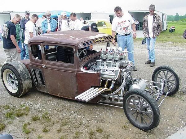

To be honest, as long as the axle shafts are balanced, they'll be fine as he did penetration welding.
Now the driveshaft, hubs, ect.... Or how about the rear shocks that are at an extreme angle and aren't going to do jack?
64
Construction work doesn't get much in the way of torque applied to it....
Were they heat treated?
What filler did he use?
How is the adjacent steel affected by the heat from the "penetration welding"?
Seriously I'm not slamming you Poodles but this is why people SHOULDN'T do this type of work at home....
You're using an example/justification that doesn't apply in any way shape or form to the work being done.
He would have been far better off using a precision fit tube and welding it at each end, but his cocky shit blobby welds are so full of inclusions, air pockets and contamination it would probably still fail.
