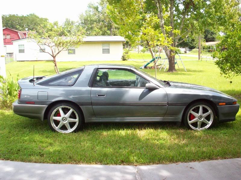

We have 2 antenna wires? Wow I didnt know that. But as grim said the mini plug will allow it to fit.
PS. Dude its freaking scary how close our cars look alike.

Wow that is scary!!! We basically have clone cars. LOL The only problem is that the california sun has fried my paint. How is yours holding up with this color? Im saving up to have mine repainted as soon as possible. Return it to its factory color of course :) Also, what do you mean both should work? Because my aftermarket head unit seems to have only one plug for antenna. And the mini one is too small to plug into it. The larger seems to fit ok, but no signal. I must be doing this wrong.

WOW I have to say I love the way my car looks :)
