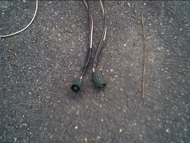

the knock sensor connectors on 7m's are GREEN, and circular. (very much like the blue connector on the t-stat housing, but green, and only one wire.
edit: these are knock sensor connectors:
-shaeff

That clears some things up for me. If that's the knock snesor wire-connector then what i am looking at is not it. Either that or someone else tried to wire it up. Here is a pic of what i am looking at unplugged
maybe this is just the wire coming out of the connector?
If and when i ever do find it, what exactly should i do? I can seem to get a straight well explained answer.

that "vaccuum pump" is the EGR cooler. that connector looks as if it slid out of the actual plastic connector, ofnarcr4. if you could get a better pic of it, i could tell you for sure. is there a circular rubber boot on the wire behind the metal connector?
you should just do this anyway:
http://www.supras.com/06/techcenter/display.php?QID=69
