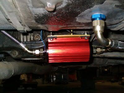

I'm also running an A1000, many trips from NYC/FL to Canada. The only problem I had with them is level on gas in tank, if the gas is too low like 1/4 tank full, the pump tends to die out (over heats). This is stated on Aeromotive website.
To defeat the over heating problem was to keep it above 1/2 tank and if I do get stuck, I pull over and let it cool. I'm planning on putting a MKIV or Walbro intank with a toggle switch to kick on if I ever do get stuck. This usually happens in the hot summer days. It sucks to be stranded out in the boonies hundreds of miles away from home, it ain't pretty, especially with no AC :cry:

You need a surge tank. It is kinda like what you said but it works more like if you have low fuel, this other pump (in tank or outside doesn't matter aka surge tank) will keep the big pump flowing at all times. No need for a switch. This is somehting I am planning to do but haven't gotten to it yet. :)

I guess you COULD but why would you want to? It will defeat the purpose of having an external pump and dont' forget the benefits of having it this way also.
I say go with a surge tank that will be outside with a small tank then have it feed the big pump (only when it gets to low ) and no worries :) That si what my plan is. The Aeromotive pums are very reliable so stock trying t6o make up your mind. Your are going to listen to me :biglaugh: J/K
