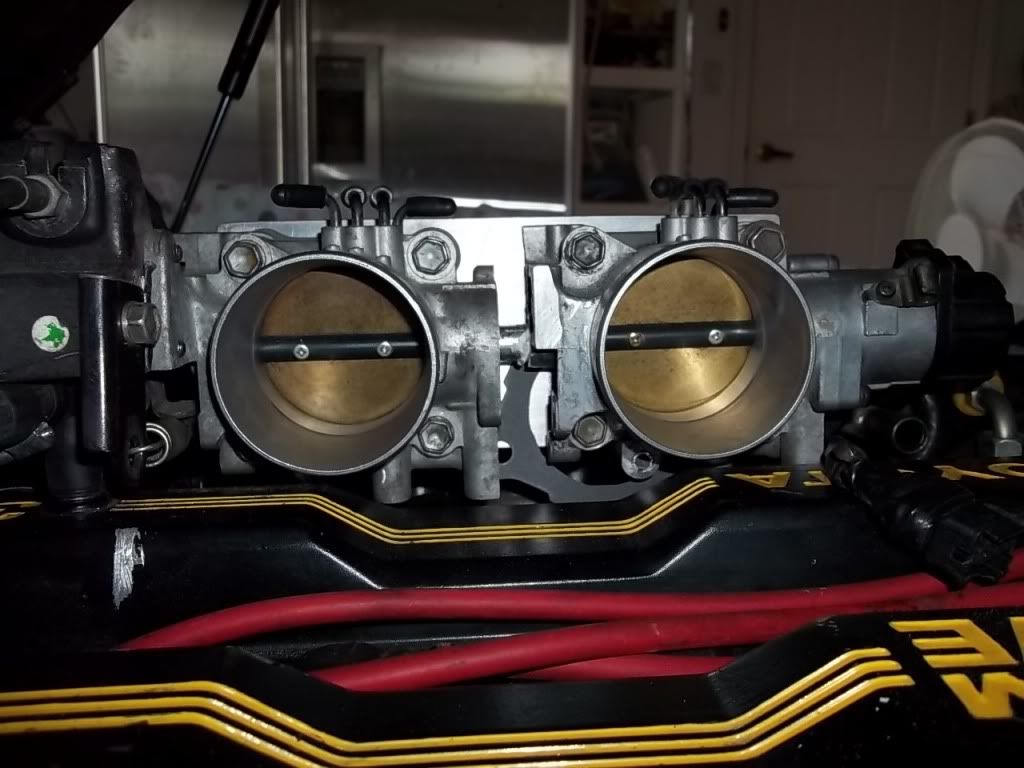

Looks baller cool fo sho! But really, that's a very ingenious way to put together a throttle system! Well done :)

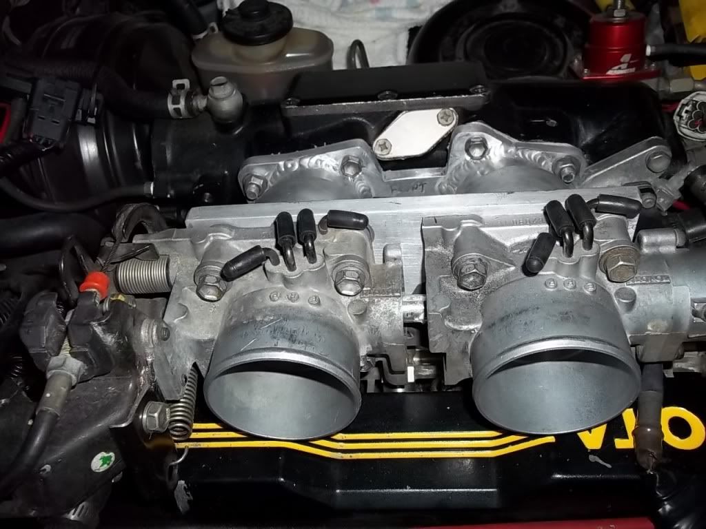

Thanks, special thanks to aus87nat, for his help and insight. Especially liked his idea of running 2 stacks thru the hood "Mad Max" style, lol, but we have a lot of rain here in Florida.
Throttle bodies are 60mm, response is fantastic off idle. Have to hook up the laptop and do some tuning now.

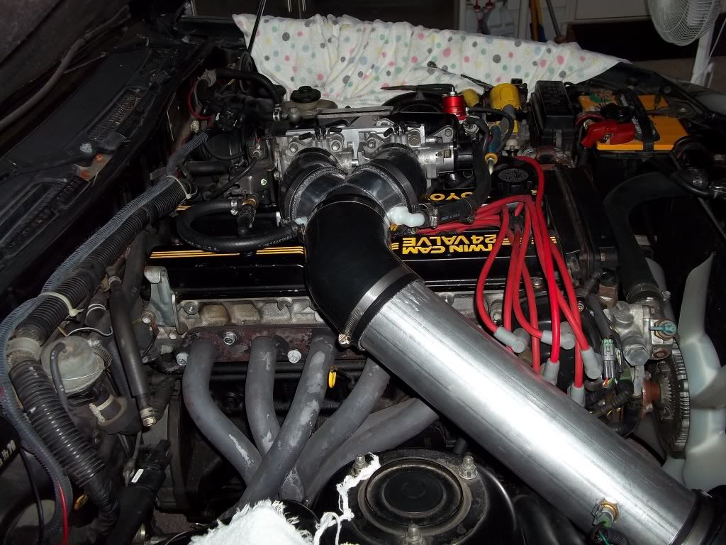

hvyman;1692680 said:
Are you running a ems?
Maft-Pro speed density. With first start up had to put back 10% fuel for it to idle at 14.7afr. Hope to have to put more back in with the increase in air.

Damn. Stock block? head? Stock weight?
Interested to see what the results will be. That definably has to be a fun n/a car.
Not very much stock, my profile has all the mods too many to list here.
mkiiichip;1692760 said:
Nice setup. Are those your welds?
Props.
Thanks
No those I had done, everything else I made, would have done a little more to "pretty" things up but wasn't quite sure everything was going to work out. Plan on getting the 4" intake pipe coated, adding a box around the intake filter, and shielding the headers.
