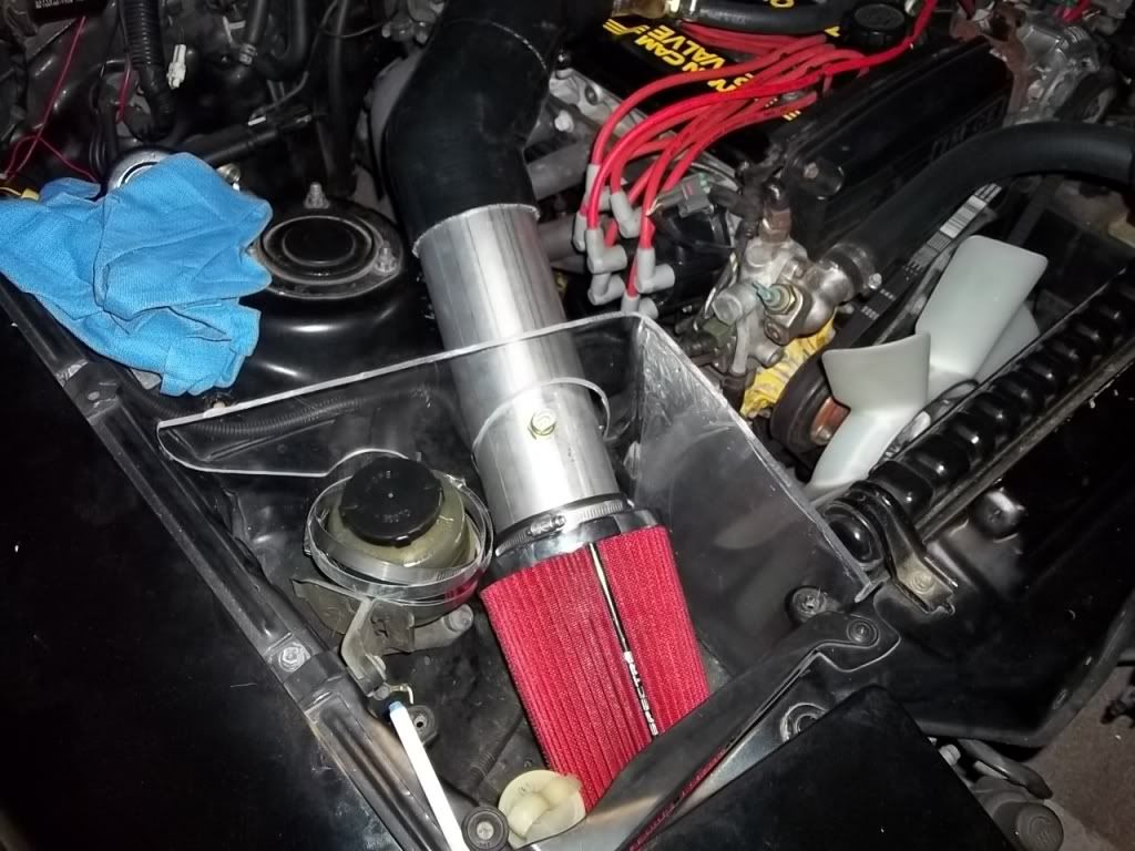

Thanks IJ, not as innovating as some of your "stuff" but I'm pleased that I was able to make everything and make it work.
I know that's a lot more throttle body than it will flow, but I have a lot more fuel than I can use. :)

So far with preliminary tuning I've had to add 25% - 30% more fuel, more than what I had expected, guess that's a good thing:)
Throttle response is very quick, no wot driving yet, my laptop crashed so have to wait for my son to come back to resume tuning.
BTW anybody that is thinking about doing this should know that you will need to be able to tune i.e. piggyback, larger injectors, afpr, and probably a few other mods to even see any gains. Don't believe it would even run without them.

Love it AJ, that Y piece looks so good. You're still running the ACIS aren't you? I think will this will make a bit better use of the ACIS function and you'll get most of your 'gains' at part throttle or low speed. Keen for track report when you get it going properly :)

Thanks Matt, Yes still have the ACIS, can feel it at 4k, didn't feel it before I think I will be able to "smooth" it out once tuning is complete, if not has to be the increase in air no biggie.

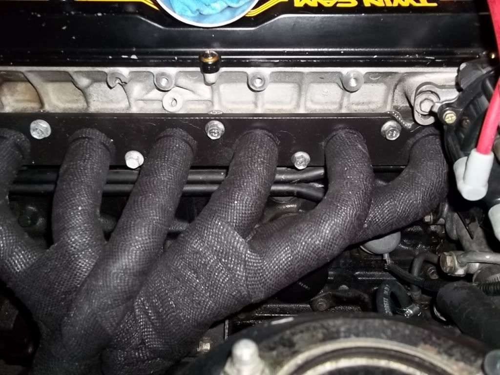

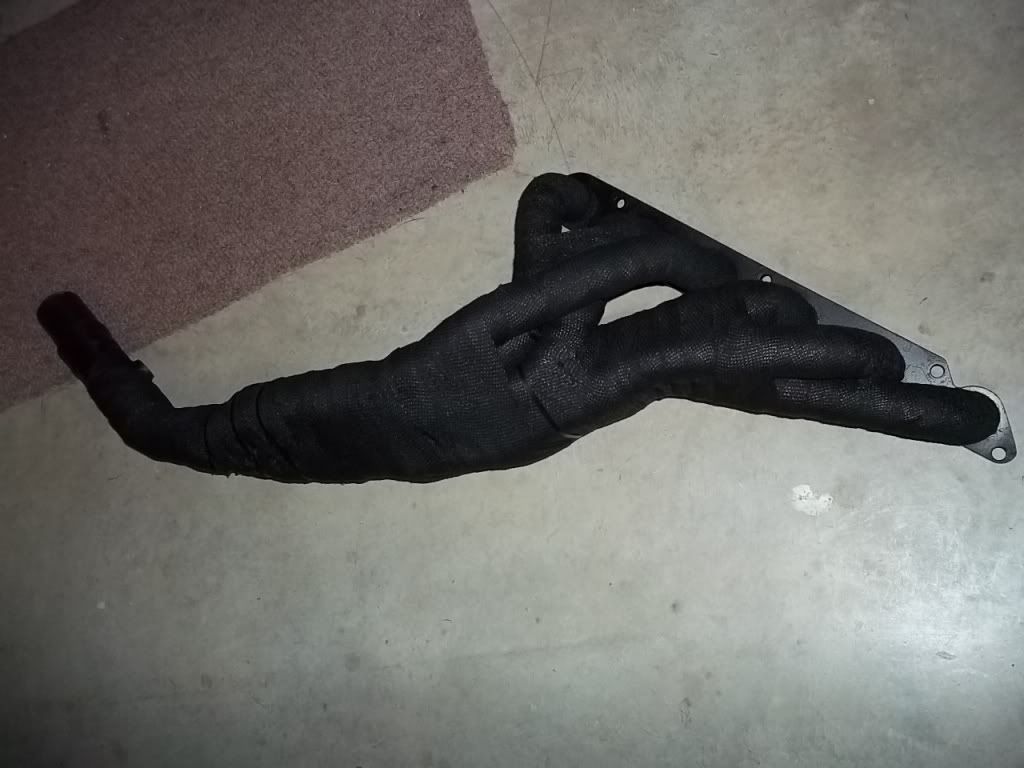

Thanks, here's the latest improvements

wicked Dude!! it makes an inturesting sound! just need one hell of a torqu converter lol!
