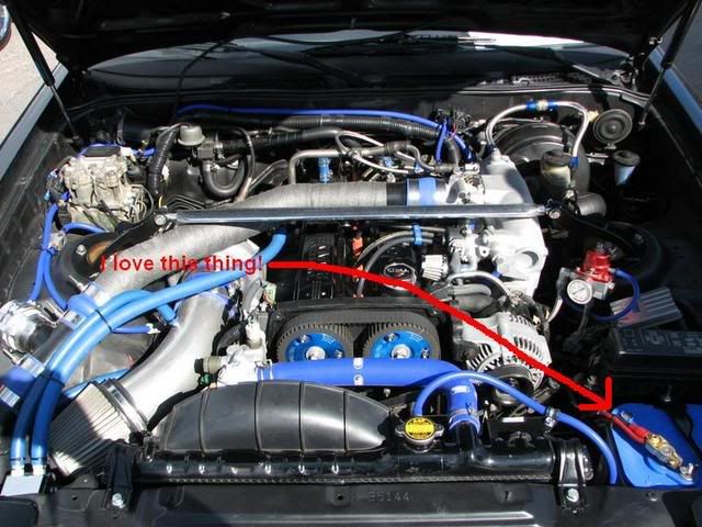

I know I saw one on a Supra somewhere before...
