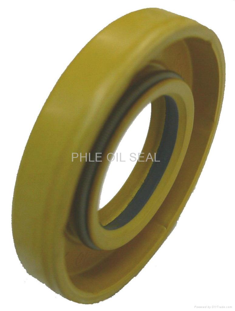

Which way was the seal facing when you installed it?
A:
B:
Did you pull the timing case to do the work?
If so how did you reseal the HG and Pan?

A: with the plastic on the closer side and the hollow side with the spring and stuff facing the engine
B: No I did not
Edit:
haha I confused myself. ignore those A's and B's ^^^ I read you pose wrong I installed the seal the B way

Now and again when you install a Lip seal the preload spring inside can pop out of it's groove so the seal leaks badly when under pressure..
NOT saying that's the case this time but it's possible.
