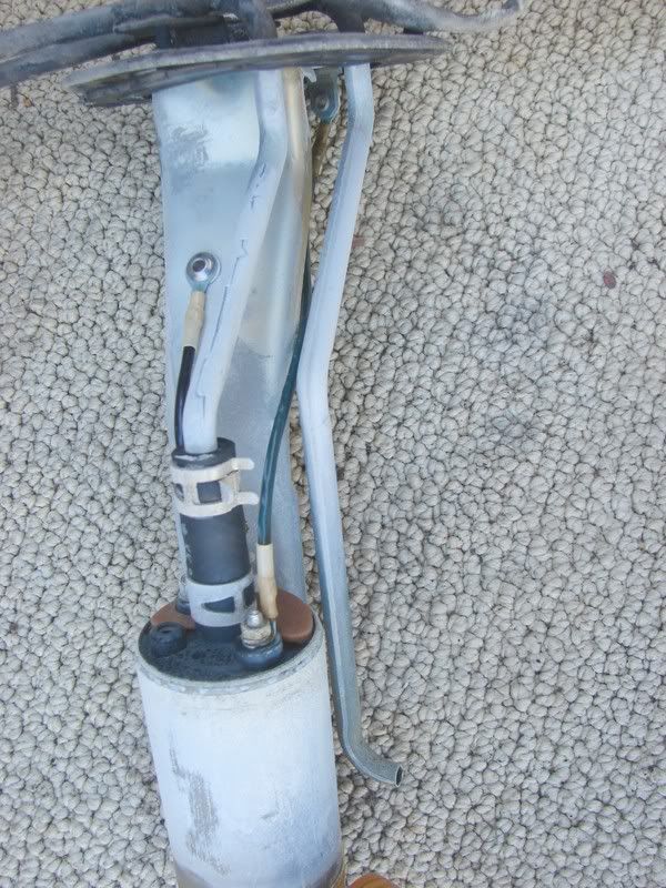

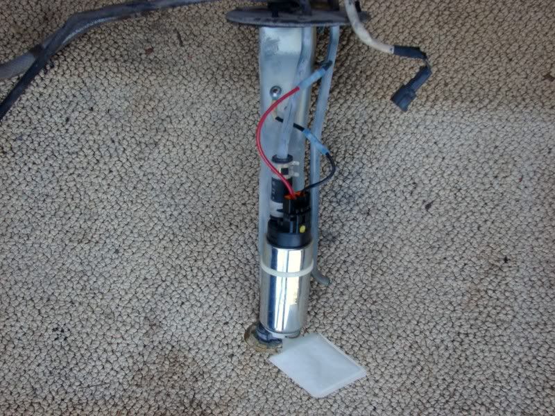

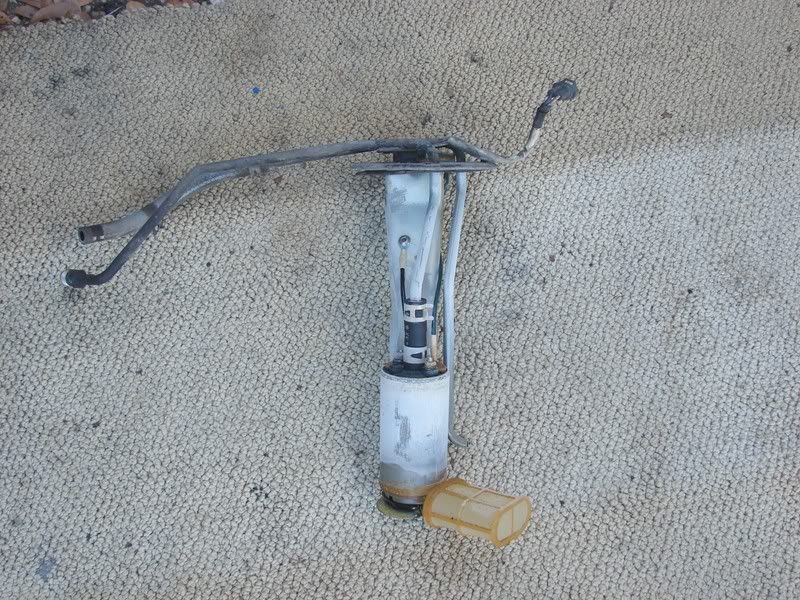

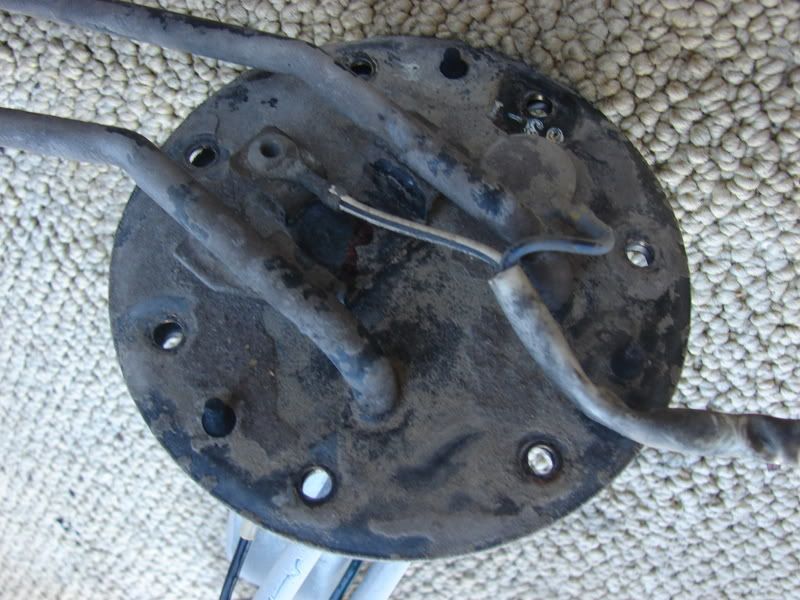

Now that the tank is out, you are at the easy part, which is actually swapping out the fuel pump. I found this to be the easiest part of the three phases (removal/install of the tank, pump swap, wiring 12V mod) of this job. You are taking out the piece with the two hoses running from it. There are 8 screws (you can use an 8MM socket too). Once it is out, you cut the two wires leading from the pump to the top of the bracket you just removed. You will plug in the harness into the pump, and use the butt connectors provided in the kit to connect the wires to the that you cut. Pay attention to positive negative here! You can soder these wires if you would like, and even use shrink tubing to cover that if you wish. Replace the hose at the top with the new hose provided. Place the new pump into the bracket, and zip tie it to the bracket. You just installed your pump, put it back into the tank. I waited until I had my wires for my 12Vmod wer done there. I used a lot of wire, and cut it down later.
Pump bracket
old pump
close up to see wires you will cut
New pump installed
I will update again with 12V mod info and pics as soon as I get time this evening.

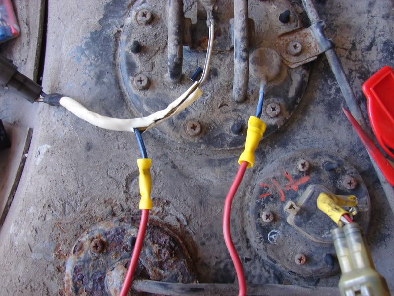

This is wires 1 and 4. You will cut the blue wire on top of the fuel pump bracket. Wire 1 will go to the piece of that blue wire that goes into the pump for power (wire on the right). Wire 4 connects to the other piece of the cut wire (wire on left). When your key is on, power comes from the harness, and runs through Wire 4 to the relay.

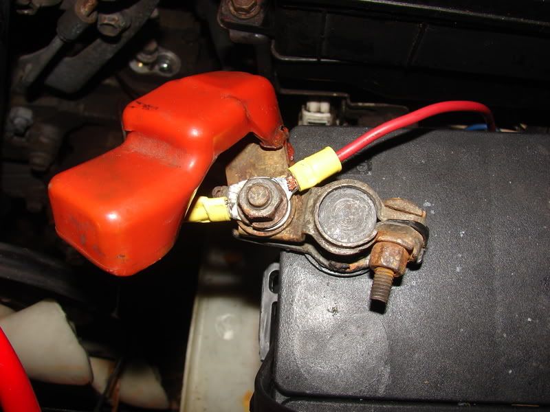

Wire 3 is the fused wire that you run from your battery to the relay. With my car still in the build stages, I had a real easy time with this wire. Double check now that your negative battery cable is taken off of the battery. I ran mine out of a small hole down in the corner on the negative side of the battery. Then once in the inner fender, I put my fuse into the wire. The inner fender is held in place with simple screws. Take it out, so you can run your wiring under there in the wiring clips, and into the car where the body wiring harness goes in. This is where you want to attach your wire to a coat hanger with Duct or Electrical Tape. It comes into the car near the fuse box or clutch pedal. (My mud flap is off, and the lower two bolts of my fender were out, so I could move my fender enough to see where I was going and find the hole. I don't think this is necessary, but it certainly seemed easier with it moved) Then I worked it over to the steering column, and into the area where the stereo is. You will remove the stereo bezel, stereo, console and lower rear seat. Run your wire (still on coat hanger) under the carpet from where it starts under the console to where it comes out at the tip of where the rear seat sits. Then run it under the rear seat top on the passenger side to the hatch area. I pushed my wire under the side interior plastic to where the trunk board support is, and around the corner unseen to the first bolt on that part. I will show several pictures here.

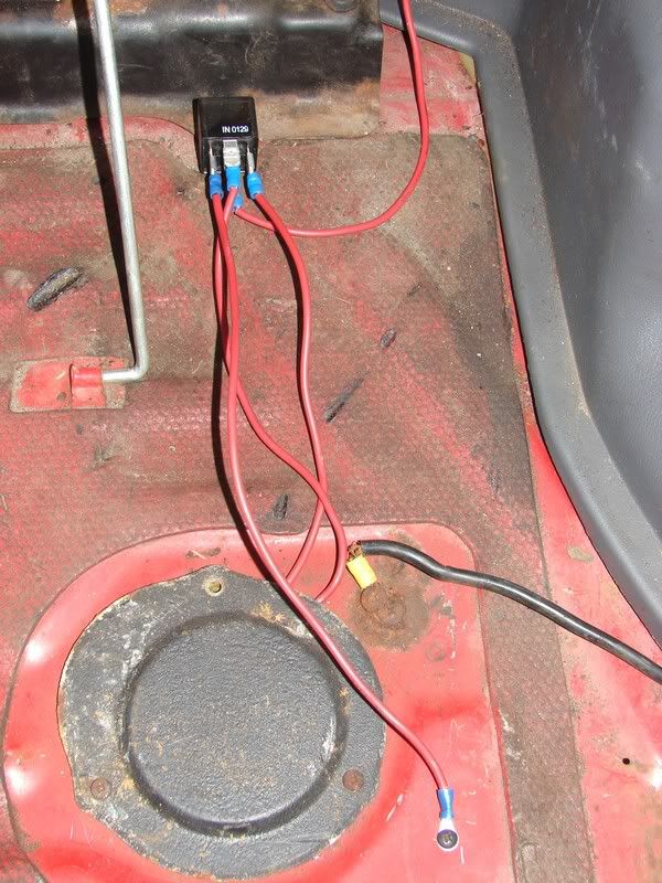

Wire 2 is a simple ground wire from the relay to the trunk floor. Do as I have been instructed to do, and sand the area that you plan to make your ground. I drilled a pilot hole, and used one of the little black screws that our cars are full of.
Wire at the battery

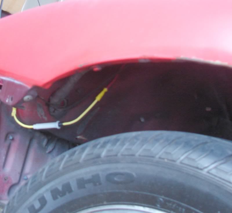

Here is my inline fuse that will be protected by the inner fender

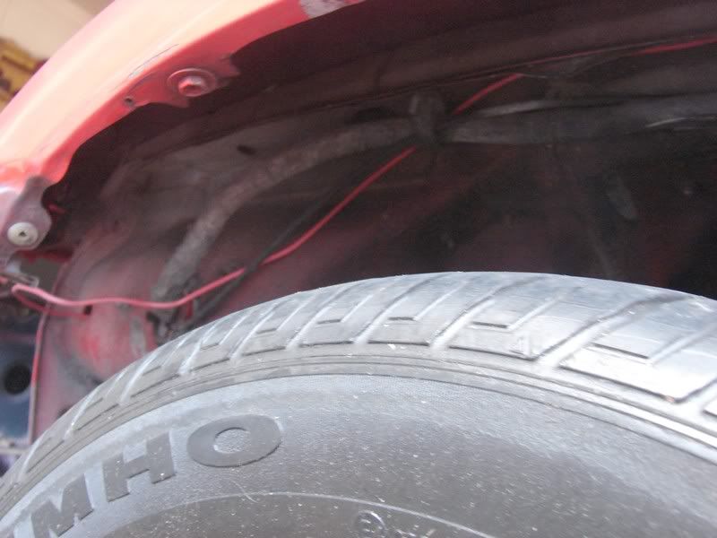

Wire continuing through the fender tucked into the wire clips already under there. Picture taken before I put the fuse in.

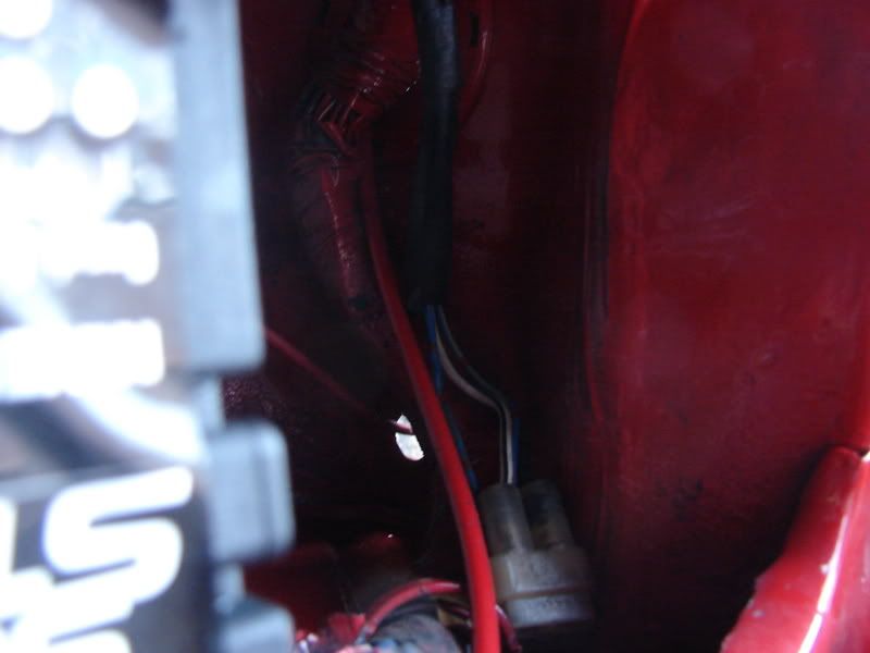

Then through the hole into the car, coming out near clutch/fuse box , and across to the stereo area. Sorry no pictures of this more critical part!

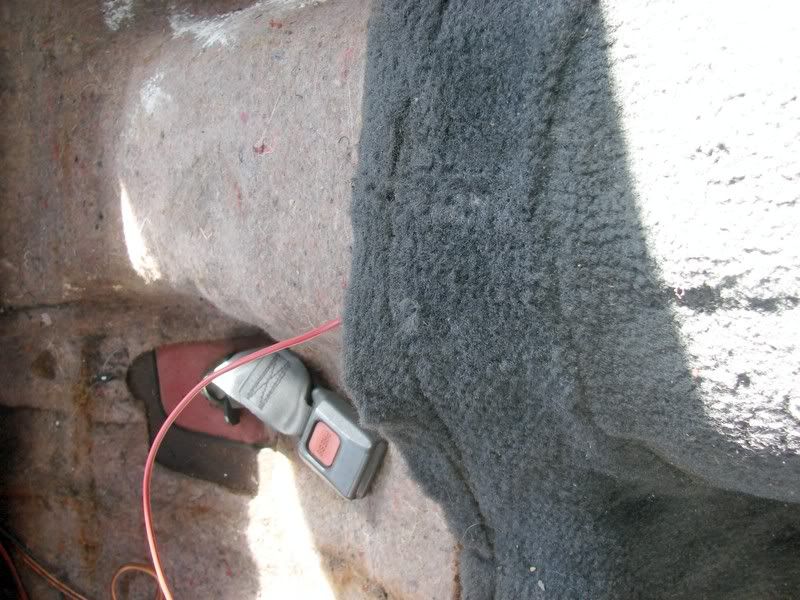

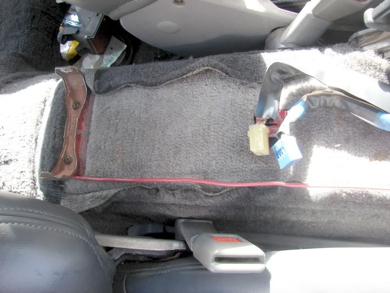

Now under the carpet and to the rear seat. My car has a second carpet glued on top of the original, and this was much more difficult than it should have been for me.
Then push it through to the hatch area and to the first bolt on the trunk board support. Here is how I mounted it. You can now see wire 2 in this pic. Be sure to sand off the paint.

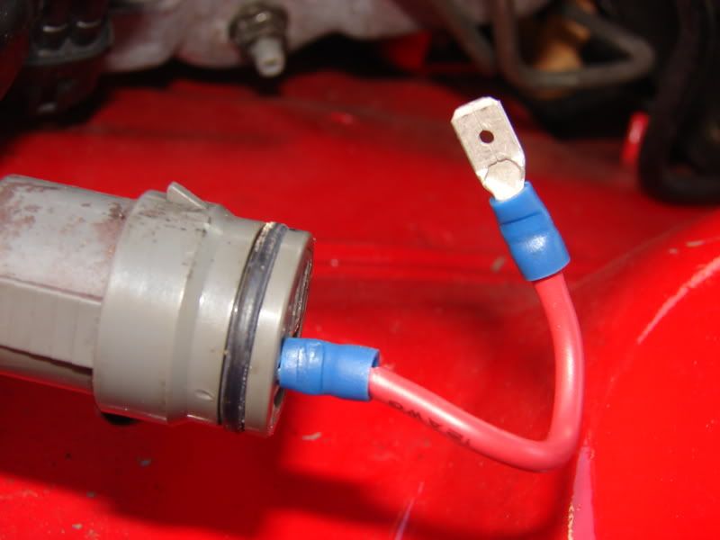

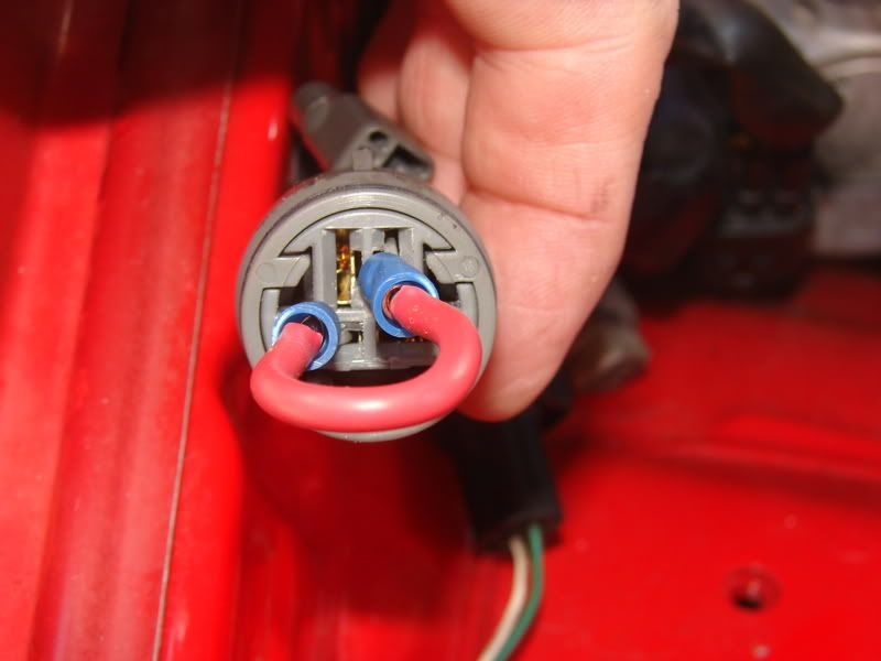

Now, the last step is to bypass the fuel pump relay and resistor. They are pretty much useless when upgrading the fuel system. Here's a picture of it done, and of the connector you need to use.
Pump bracket
old pump
New pump installed

Wire at the battery

One suggestion, you want to put the fuse as close to the battery as possible. You have it too far away IMO and have routed through a metal body panel. Any accident in that area could crush the metal enough to slice through the wire causing a short.
Also you want to make the fuse itself easily accessible in case it blows for some reason.
Finally, is that fuse holder rated high enough? The Walbro pulls 15-20A.

^ a good suggestion, per the MECP install guide, fuse within 18" of the battery is acceptable but definitaly want to make sure easy access to the fuse.

Im so sure I posted this but dont know what happen. When bypassing the fuel pump relay and resistor, I can throw that thing it connects to away right? Never need it again? Also is this that relay right next to the top part of the suspension in the engine bay on the passenger side?

I would also not use that style of fuse holder. I've ran into problems with that style many, many, many times. Instead, use a holder like this, its water proof, uses a more common style of fuse, and all around is just better.
