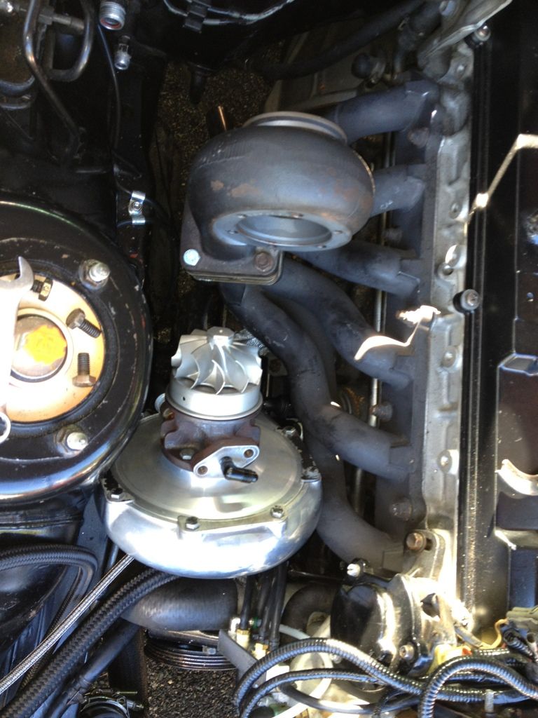

kotu100;1884454 said:
I take the chra off the exhaust housing and do it that way.
im gunna have to try this way. even with the comporessor housing off, the back piece still blocks me from being able to get to the bolt. how did you get to the backhousing bolt at the bottom by the flange bolt? especially when its on the manifold? it look real tough to get anythign in there. Havnt actually tried yet.
kotu100
Nov 23, 2006
1,899
Easton, Ma
I just used a 1/2" stubby open end wrench to get that rear exhaust housing bolt off. You can kinda see it on the shock tower in pic.
mk3-4-me
May 19, 2010
669
Milwaukee, WI
ok thats what i was thinking. Ofcourse, when ever i need a 12mm i find 1/2 in wrenches, and now i cant find 1 1/2" wrench. So im going out to buy one now.
