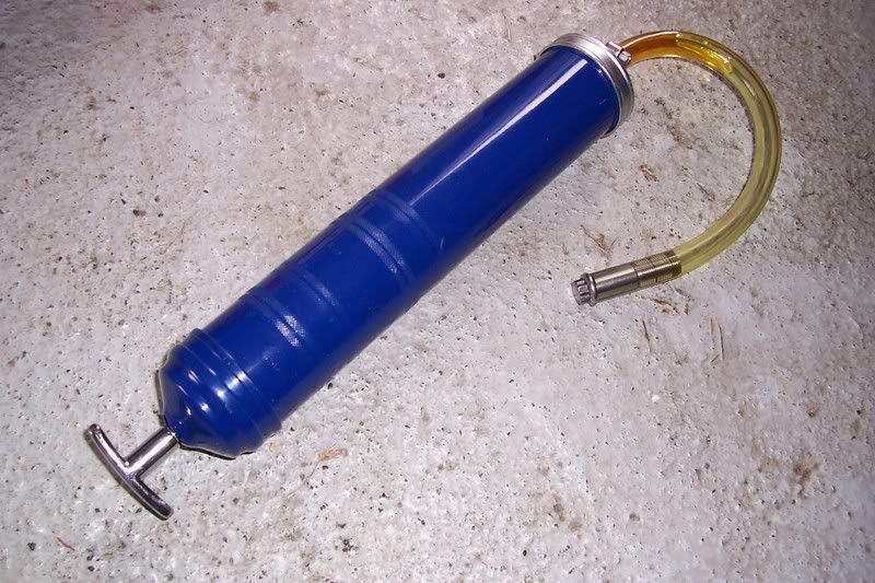

As far as the "pull the fill plug first" I disagree. The way I look at it is, it NEEDS to come out one way or the other so I say it is a motivation factor to take it off if stuck. (my .02)
Buy one of these to fill. You can use it for both tranny and diff ;) This is what I use.
you may cause more damage in the process or just trying to get it out.. especially if it seized or stripped.
