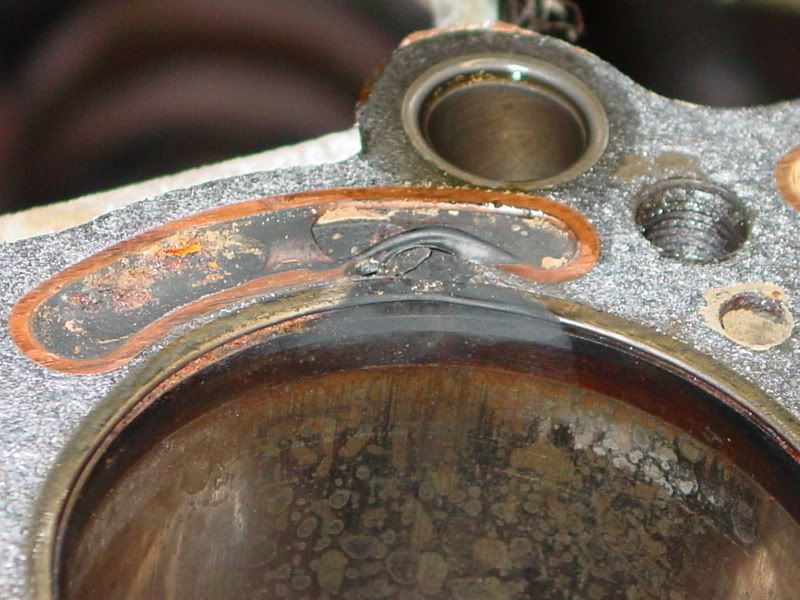

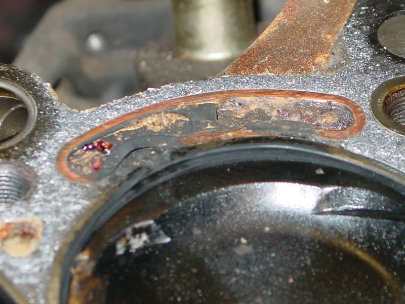

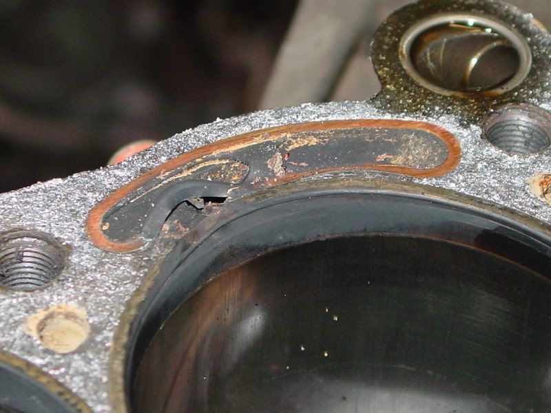

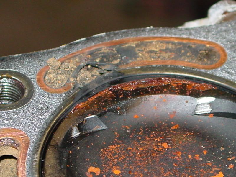

This month went back to the Supra. Started with tearing down the turbo engine I picked up. Was able to 100% confirm BHG.
The claim was that they had just replaced the HG the month before and it still overheated. They ordered one of the Ebay motors and I got this one for cheap.

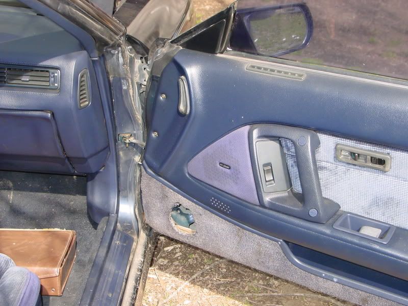

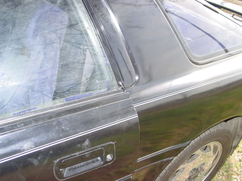

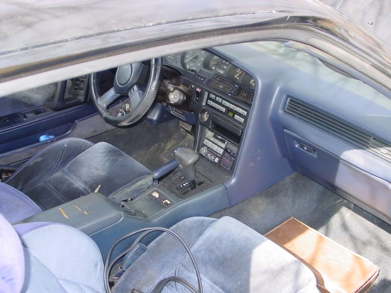

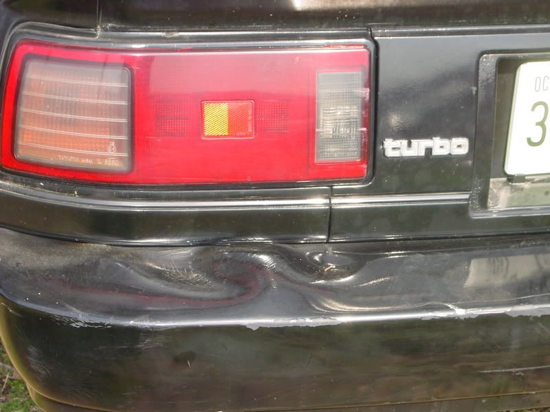

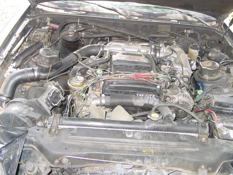

Then I got an entire turbo motorset to swap over to my car. Originally the guy wanted to swap cars. After looking at his I decided that was a no go. Then he proposed swapping drivetrains. My NA motorset for his turbo motorset. His is suffering major wiring problems and mine runs fine. After some consideration it is underway.
Here are some pics of his car and why I didnt want to do a car trade.

Yikes, that looks worse than the harness that was in my car. You should be able to pick a decent used one up for $100-150 and be ready to rock...

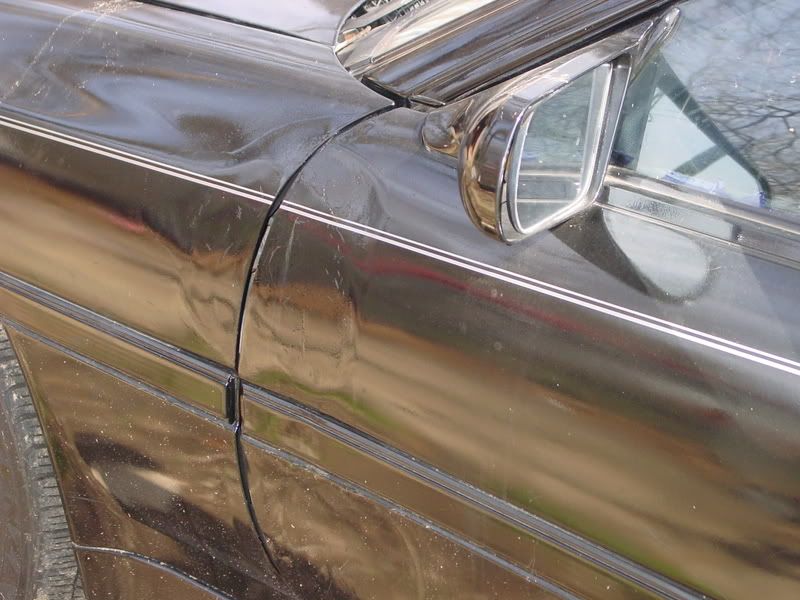

Have already found another harness and ECM for myself. The pictures really didnt capture how crap-tacular the black paint is. It was either a rattle can or sprayed on with too much pressure. Really bad orange-peel going on. Plus the mouldings are painted black as well. The door pic was taken straight on. That is how far it drops when opened. Much like many older Chevrolets.

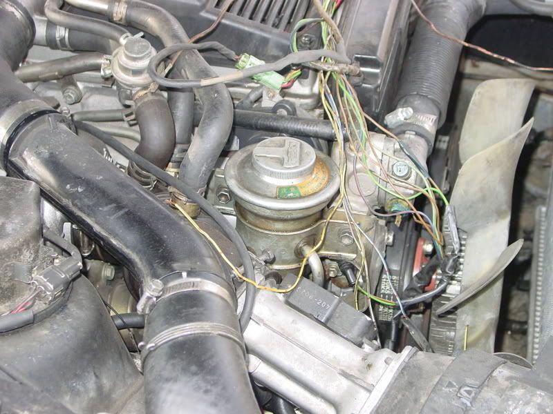

Am in the process of getting the turbo engine out now. Everytime I take soething out of the way that harness and engine install looks uglier.
A little background on the turbo car. He bought the car and immediately blew a HG. Had that reapired and drove for almost a year when it blew again. This time the shop (which will remain nameless for now) talked him into getting one of the Ebay low mileage motors. They swapped the motor in and botched the wiring from there. It only ran for 3 days since the motor install. He has spent an embarasing amount of money and even more time trying to fix it with no success.

These wires are just rubbing metal and have been taped together. No telling what is hiding under the tape.

damn that's ugly! i cleaned up allllll my wires before hand. soldered, heat shrinked, loomed and then taped. i think wiring is fun, but that just looks terrible

lol at the black wire. I had that too on mines. Is it connected to a brown wire on the cps plug. I found mines leading to the ecu. Connected to another black wire which I think was the ground wire.
