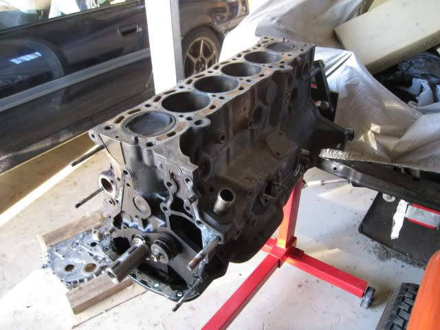

This I did not know, I just hammered it in with some FIPG around the edges.
How does one center peen?
I took pics of How I installed it, will post tonight after work
Sounds like this could be the problem, that front welsh plug is a bitch. The front plug is a special type of welsh plug which is close to the same diameter of the hole in the block. Once you put it in place you need to dimple the center of the plug which makes the outer diameter expand and make a tight fit into the block. Its best to let a machine shop do this, because if you dent it in too far you will reduce the size of the plug again and it could pop out. Also make sure you use a good quality plug, I wouldn't use anything besides an OEM plug installed by someone who really knows what they are doing and have done these before. You probably need to do a complete teardown at this point considering all the water that got in the oil.

I am pretty sure it must be mis-instillation of this freeze plug
What exactly would I be paying a shop to do. Noone has answered that. Do I simply need to pull the crank and clean the journals of milky oil?
This motor has NEVER been road driven and its cumulative run time is less then 30 min. Do I REALLY need to rebuild the bottom end or just flush the bottom end?

Is it just me or is it in backwards? It looks like it is in the pic.
"Hump" of the plug should be facing out when installed, then center peened (hammered)

It is for sure in backwards, That is the mis-installation I did. I had never encountered a freeze plug like that before.
I think it has been installed backwards.
Pic of my original block for reference...
