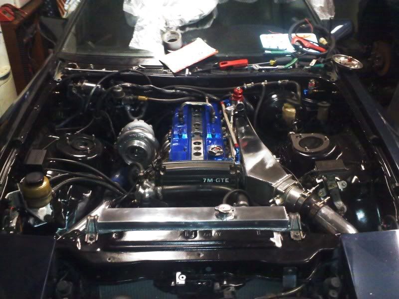

kneedragger85
Sep 9, 2008
363
Boulder, CO
Also running -10 drain and HKS long runner manifold with adapter. FFIM, IS300 coils, and a checkvalve pcv system are soon to be added this winter.
Turbo87targa: You can check my setup out when I get it back together. I'm in SW Denver and will more than likely make a trip to CO Springs to visit family soon.
