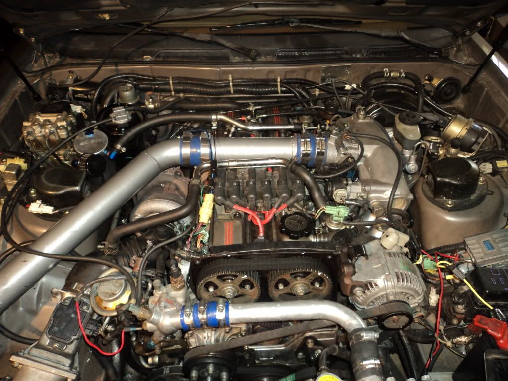

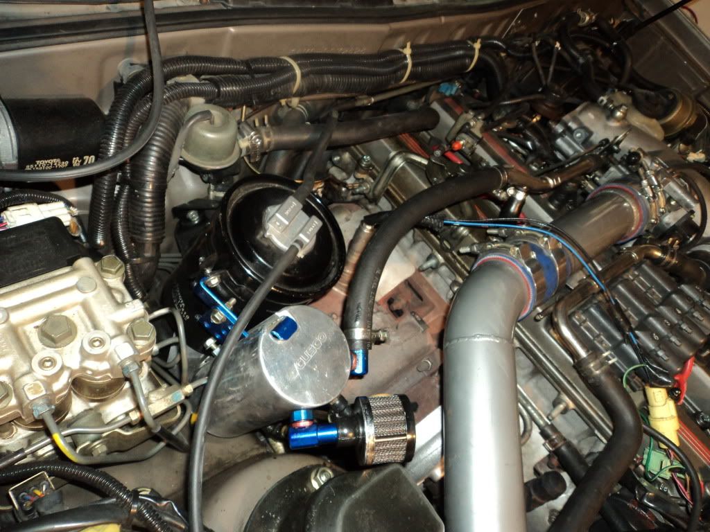

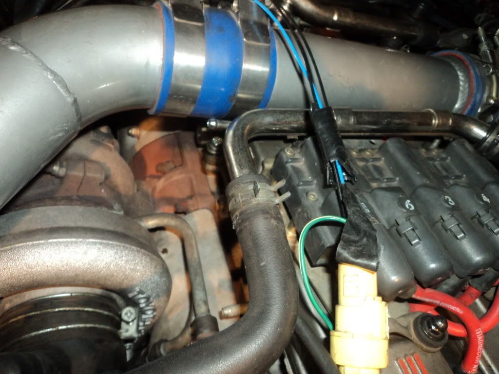

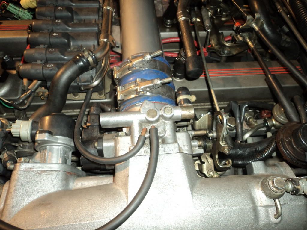

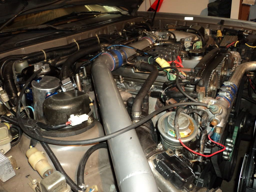

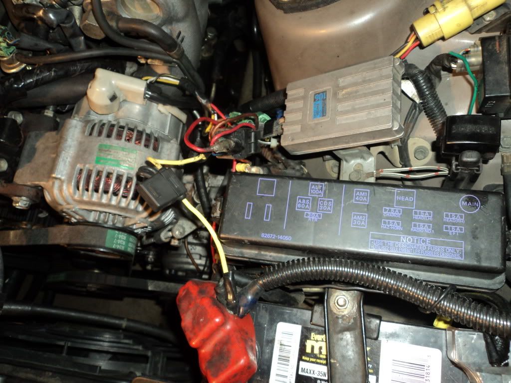

here's some pictures of the motor, don't know if it'll help but just to give you guys what has been done(nothing really), the previous owner did all the blocking of hoses and such. and custom wiring for the Electric fans.
Cold start injector time switch/charcoal canister vsv/turbo coolant line aren't so great, same goes to my Engine Harness, i need a new one.
this is the Custom wiring for the Electric fan, done by a good friend
Hose lines that are blocked or has no hoses to them
thanks for looking at this guys, i really appreciate any advice or suggestions from anyone.

Your catch can setup seems wrong. The only time you'd get any crankcase air to go to it would be during boost, and since it's vented to ATM, that means its a boost leak. The air filter should come off, and that end of the can should go to the accordian.

i was looking at the Repair manual and my BVSV setup does seem wrong, but this setup isn't done by me, its done by the previous owner before my uncle had owned it, that had this car before. my uncle bought that car, then a couple of years after his ownership, it wasn't drivable, putting in 2-3 thousand dollars himself to fix the training and etc. but haven't seemed to fix it. since then it has been sitting in his garage for about 5-6 months, and then now i'm trying to fix the Supra up.
