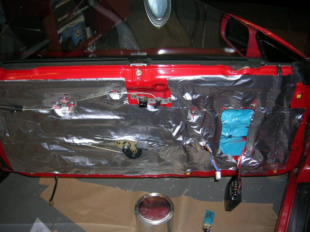

pbasil1
Fully built 1JZ project
Jan 30, 2008
402
Huntsville,AL
My solution.
http://www.carforum.net/showthread.php?t=1699
I can build you some adapters to put 6.5" speakers in the doors for a small price, and i would really recommend going with a decent component speaker setup with a small amp to power them. For those who have stated that you can get any good bass out of a 6.5" soeaker, you are all wrong.
The enclosure makes about 70% of the sound. Not the driver. So if you have a crappy enclosure, in this case a non sealed or tuned car door, then mid and bass response absolutely sux! The ultimate setup is to build an independent speaker pod for the driver, but this takes much skill to make it look half decent, and it takes up leg room. So the next best thing is to seal the doors as best as possible. Dynamat or some other good sound deadening should be used on the doors. Both inside and out and if done right, you can get some decent bass from the stock speakers.

ImpulseDrive
Apr 23, 2007
123
Brooklyn
^^ makes me wanna go fishing :-D.
Basil the Dynamat thing looks awesome and easy to do. I checked prices and I guess its around 50 bucks for enough for the 2 front doors. You did a great write up and honestly the final version looks awesome and you have talent. Still I'm not the type to want to drill holes or anything into my door and stuff. I'm not TOO much of an audiophile, just getting a better bass quality would be enough for my listening pleasure and the Dynamat , small amp and new HU would probably be all I need since my front 6.5 are arleady upgraded to pioneers.
