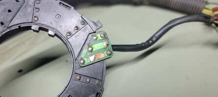

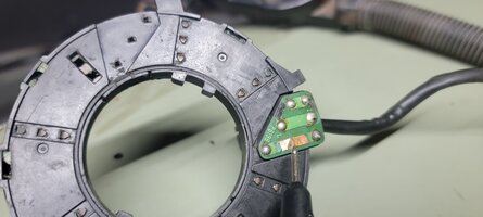

This is for them computer tech guys. I figured i would look into why my horn was not working and why the previous owner bypassed with a autozone switch for the horn. Diagnosed to the multifunction headlight, turn signal, windshield switch and noticed this break in the horn board circuit. Is this a simple solder repair or does this require a more precise repair technique? Should I attempt this repair or take it to a computer shop? I'd rather fix this then to spend $300 on another one. Connection between all other points are good until right here.

You have to wonder why this happened in the first place. Is it a rubbing contact? I would just carefully solder it after cleaning it with a brush or razor blade. Don't apply too much heat, or it could melt.

Not a rubbing point or does not come in contact with any other parts. Reading the continuity and voltage going to the horn all seems ok. Wonder if this was a bad part from another supra dropped in here. Will probably take this to a computer repair shop to see if they can fix it as they should have all needed materials to fix properly.

I do have a soldering kit but wanted to have a new trace put in as well as new solder mask to protect from corrosion. Plus my hands are not as steady as they use to be.
I did find a computer repair shop near me and one look the tech said yeah man that is a easy fix. He said he would have it done by tomorrow and only is charging $20. We will see the quality of work when I pick it up. This place has a ton of good reviews. The tech says he has repaired car parts including ecu, relays, ect.

Welp got the part back from the computer shop. Lol should have taken a picture of the finish product before I got too excited to test and installed it. He did a good job. Everything works properly for the horn now. Woot woot.

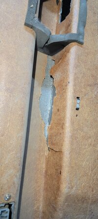

Soo question, I have my driver door panel off and noticed this. Wondering what is this made of? Kinda looks to be some kind of board. I'm thinking if I fix this with fiberglass, would it work?

If I was to fix this, I'd do it much like with fiberglass, but with wood glue, sawdust, heavy paper, and solid wood.
I'd mix Titebond III and coarse sawdust to make a paste to fill in the big holes. The outside vinyl should hold it, but I'd make sure that doesn't bulge or get lumpy. Then, I'd glue down a layer of heavy paper (grocery sack) soaked in glue to hold the sawdust fill in place. You could also use thin cotton fabric (muslin) soaked in glue. After that, I'd glue down some thin strips of solid wood, like poplar. The sawdust/glue mix isn't all that strong, so I'd back it up with solid wood.
Titebond III is thinner than II and will work better for soaking into paper or fabric, but II may work better to make the sawdust/glue paste. You'll have to play around a little and see.
My repair linked above is holding great!
