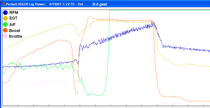

How do you do that?
Want to see something mine did after about 2 1/2 years. If it was supplying my ecu with narrow band signal, I don't know what would have happened.
edit: Oh, if you do decide to remove stock sensor; there is a resistor mod that will keep the ecu happy. You'd have to search for it cause I don't know where the info is of hand.
isnms
United States of America
2,145
Oklahoma
i80.photobucket.com
That is a small section of the log. When I got back to normal cruising it would be.
edit: This example is only put out for consideration. Everyone should do what they decide best. I kept stock sensor.
