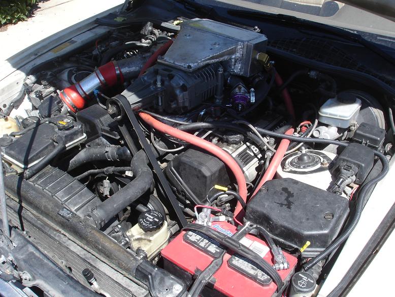

Boost Lee;1123763 said:
SuperRunner: Very nice.
How's it feel on that setup? That would be the first time I've seen that...
I like it!
Jeff
Slow. That is why I had to add the nitrous:naughty:
1uz is too effecient for an M90. Even with the smallest pully possible I could only get 7psi out of the thing. Ran a 14.0 at 100mph with using nitrous AFTER I hit 2nd gear. Would just spin on my street tires anything before that. Probably run a 13.6, 13.7 on drag tires, and at sea level, it would EASILY be in the 12's. Thing about ROOTS style superchargers is elevation KILLS THEM. And our local track is at 4600ft.

SuperRunner;1123749 said:
Supercharged is pretty sweet too. Here is one of my little side projects. BTW, for sale for $3500
http://www.youtube.com/watch?v=YsI_y-6s254
:love:
