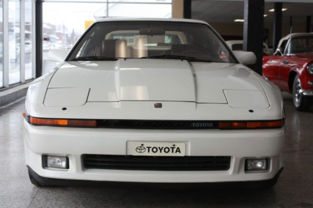

I finally talked with the seller and they are a legit classic car dealer. They mainly deal with muscle car stuff but they have this white Supra in their inventory. I was assured that everything checks out with the car. The only imperfection is a tiny rip on the driver's side seat in which the stitching came undone. Other than that, it runs strong, does not leak, and the A/C blows cold as we are being told. It was garage kept its entire life (only 80,000 kms), and is a two-owner car.
Sounds like it ticks all the right boxes. Still though. Classic car means classic car issues like parts availability. Just being cautious and looking at all angles here. It does look like we may go through with this purchase though. My dad really wants this car. At least it's not like it's an old school Ferrari or something crazy to get parts for.
The car will be kept completely stock and babied (60 year-old man), so hopefully none of the ugly pitfalls will rear their ugly heads.

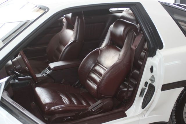

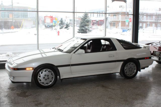

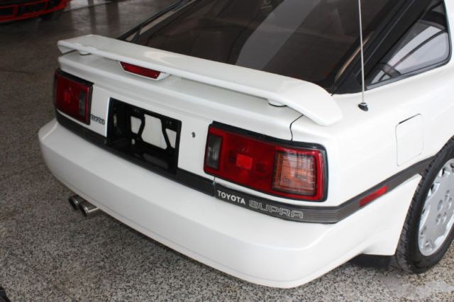

Here are more pics of the car.

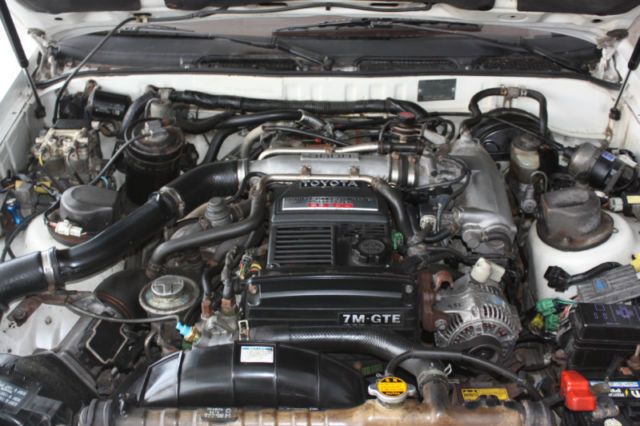

The radiator is about to pop. And once it does it's likely the head gasket will go with it. Also looks like everything steel is rusting. If the rest of the car is too not worth it.

Exactly what I saw first too. Lots of rust areas in that engine bay. That would likely spell trouble for the other parts of the entire car.

Personally, I'd pass on that car and research more.
The low miles and garage history won't have helped keep the headgasket together to start, so it's something you can expect to do or pay to have done. Also beware of low oil levels and spun rod bearings.

Overall that white car looks good to me. The radiator should be changed immediately and it would be good to see the underside to check for more corrosion. I agree with the above comment on the headgasket though. With most any mk3 you need to be prepared for at least a partial engine rebuild before it's reliable.
Are you comfortable with an engine rebuild right off the bat?
