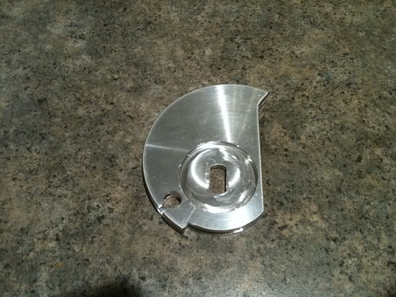

here it is, better late than never I suppose.
adampecush
Regular Supramaniac
May 11, 2006
2,118
Edmonton
I'm hoping I can get this on the car and take it out for a spin in the next week or so...otherwise testing will happen in spring. As you can see, the bolt hole was machined a tad "long", but this will allow for fine tuning of the throttle response (or hood clearance) by moving the wheel up and down.
I've got a shop that can make them...just need to get a few more people together to do a small run.
