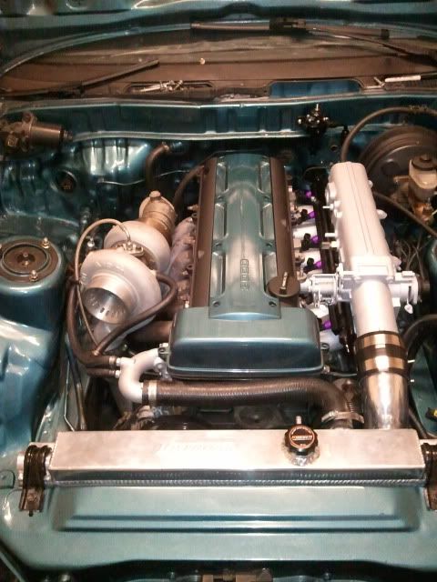

Well made some progress, started working on the fuel system and oil cooler setup. Here's some pics
Thermostat Plate
Fuel lines
Fuel pump bracket that uses the bolts differential to be mounted, I'm not quite happy with the placement Im going to place the pump above the swaybar to protect it more.
And I have re-routed the IC piping for a cleaner look as well instead of the swoop around :)

Dustin, I can see you may have an issue putting your harness back through the firewall like I did. It was a real pita to install the harness when the fuel rail already installed, you might need to take the fuel rail off and install your harness but I am sure you are already on top of this. ;)

ya this is what i noticed as well and when the regulator is put on it will become worse. going to get all the fuel together test for leaks then rip it all apart to put the harness in. Thx for asking :)

looking good dustin, does the oil cooler system have a tstat? dont think it matters since ur in AZ lol
