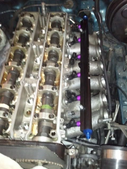

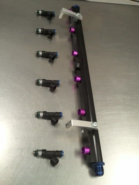

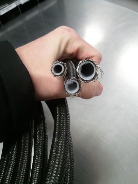

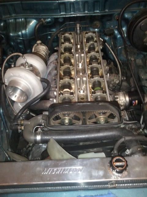

Been a while but I have been stripping my manifolds and getting ready to send them out for polish, my valve covers being sent out for wrinkle black powder coat and getting tapped for -6an fittings for a future PVC system revamp. I bought my black stainless steel teflon lines for my fuel. Im going to run a -10 feed to the motor and split it to two -8 lines to the rail. From there a -6 return. So I got 15ft of -10 and -6 and 8ft of -8 line. Also got my fuel injector clinics top feed -10 fuel rail and Injector Dynamics 1000cc injectors. Also here is a pic of the car as it sits...why yes those are Brian Crower 264's sitting in there how did you know!!
all that is left is to get the fuel pump (SX performace), get the regulator, and the fittings for the fuel line. I need to get the ethanol content analyzer and ethanol sensor and adjustable cam gears and the car will be ready to get tuned. Just picked up some sway bars that will be going on as well. So close but so far...
