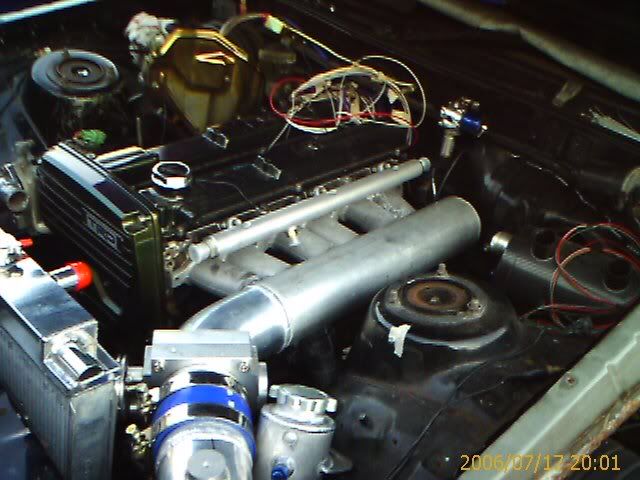

SPAWNING AN INTERCEPTOR

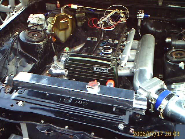

ok new parts woot woot

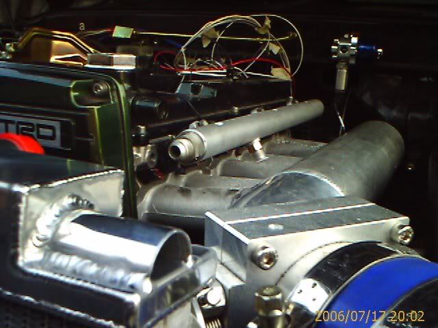

lipp fuel rail
-10 x 2 inlets :)

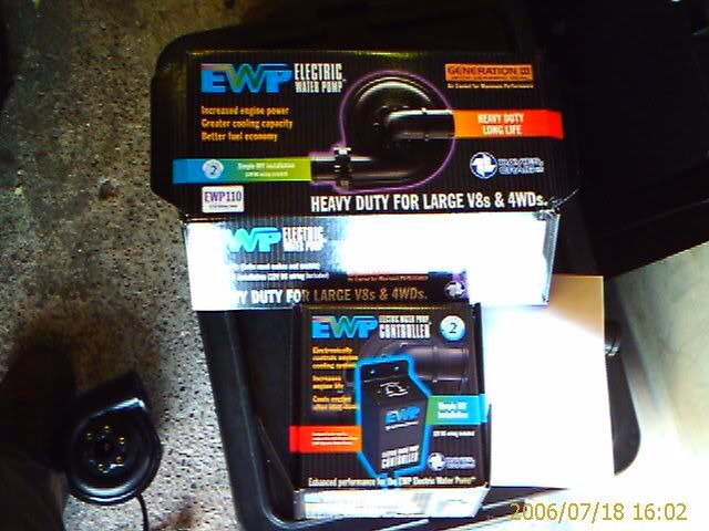

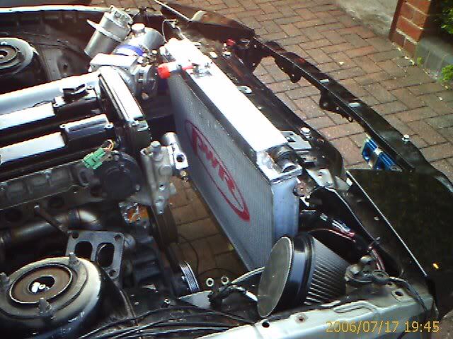

pwr rad
110lph water pump and controller
