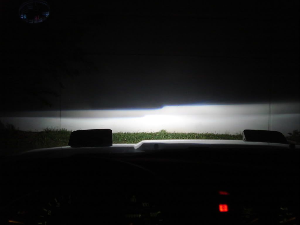

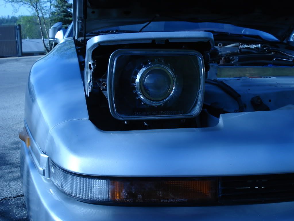

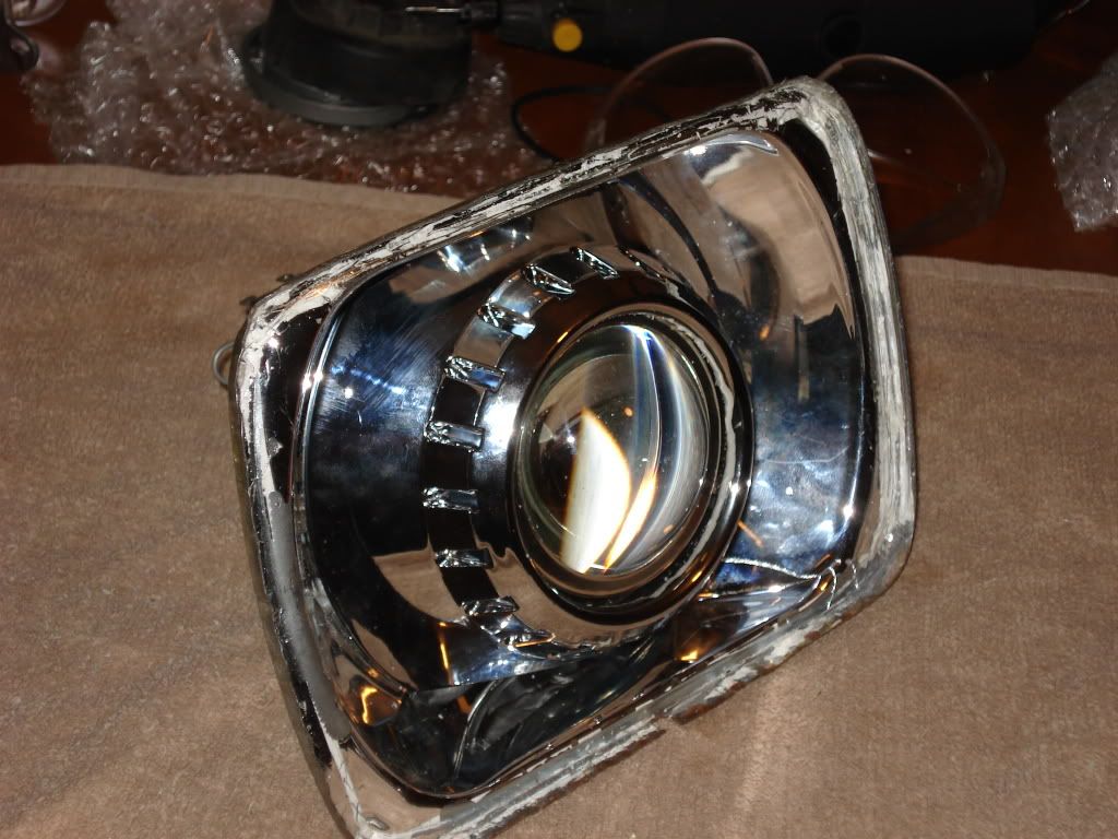

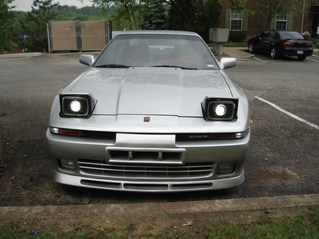

Some HID fab I work I did was to put TSX HID Projector into H6054 Housing. If I can do it ANY body can LoL...
Cut off before I Aimed the lights.

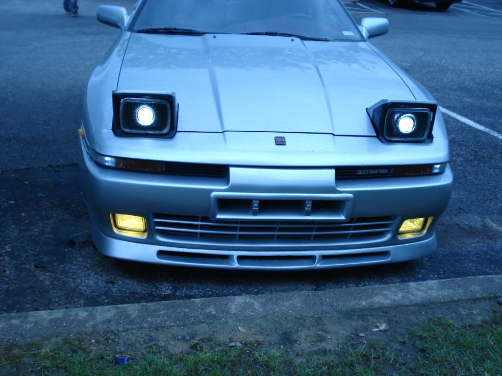

^ would you mind linking me to more pics what tools you needed, etc this might make a fun summer project. You wouldnt happen to have a pic with your foglights on as well? I wonder if they can still function as foglights lol even with HID's. I know my HID's in my E-Codes made my jdm halogen fogs pretty much useless lol unless i turn off the headlights.

I'm working on doing a wright up. I did the SOGI Fog light rewire long ago so no problem with them turning on. Also I did the Rewire with relay & it really brightened the fogs up. When I switched out to HIDs they still work well. I now have the JDM Yellow lens & may swith them out for OEM Projector Fogs for better light pattern.

Yup, projector and HID FTW!!! I have a legit custom set and they WORK!! not home made, which i do have a set that i made with rx330 projector which works great but needed more fabrication. Anyhow, Steven_N set up is sick due to the TSX projectors, those are ones of the best and has wide light out put. Nicely done!!!! Dont buy ebay housing, IF you want a nice cut off line close to that^^^ what you can do is buy the recommended housings such as Hella E-Code which cost an arm and a leg and use halogen bulbs, any brand bulbs will give you very nice light pattern for halogen housing and bulbs. Hella E-Code will cost around 80-130, if you can find them used that'll be great. I can tell from personal experience with hella. They are great!
