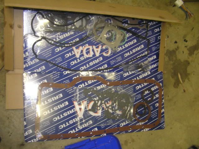

Also the gasket kit I got in last week.
Immediately toss that caulk gasket for the oil pan in the garbage :: angry ::.
FIPG or the like, will be best for this seal - trust me..
Also, I usually always opt for the genuine OEM engine assembly gasket set because of overall quality, but the others will work - I suppose.

I used the same Eristic gasket kit you have there. The only thing I did not use from it was the headgasket, I used a HKS Metal HeadGasket, and I used silicone on the oil pan. Make sure you put a good generous bead. I used three tubes of Permatex RTV Silicone.
Three tubes might be excessive but lets just say, I know someone....who was not generous enough with silicone on the oil pan, and it leaked. Tried dropping the sub frame and it did would not budge. So we had to pull the engine to reseal it. Just my experience. :-/

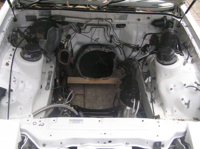

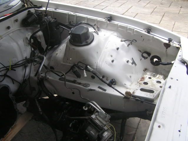

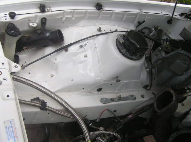

Spent the day cleaning the engine bay. Need to touch up a few places, but that won't be much hassle as I need to get paint to respray my front bar and nose cone. I'll also need to do something about the rust under the battery.
I'll be picking up everything from the machinest on Monday too, got the call this morning that it's all ready!

Engine bay is looking very clean
Say, what condition are your intercooler pipes from the turbo to cooler, I have my old hardpipe that ran to the HKS cooler (identical dimensions to stock) to turbo, all it needs is the section on the end that flared for the 35R replaced with a 2 inch section again (originally had it made when I had a CT-26)
Let me know if you are interested I dont want much for it, would just be good to see it put to use instead of lying around

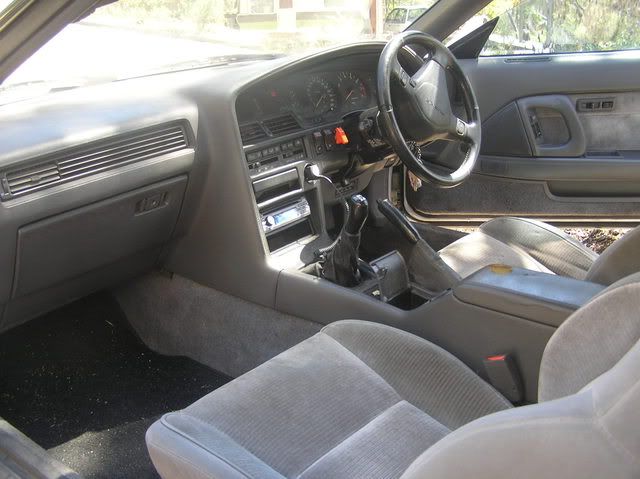

hey, upon closer inspection, it looks like your car's not a 91, but a 90..
do you have a pic of the interior door panels..?
the trim is pre 91 and so is the nose emblem...

RazoE,
The build date is december 89. Yet all rego papers and insurance papers say 91.
Guessing it was a very late december build took a shit load of time to get off the ship and was soldin early 91...
Really have no idea.

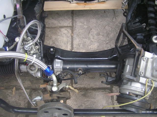

Finally got the last of the parts 2 weeks ago, and after a hecktic 4 days of having to disassemble the motor again and reassmble it, Dad and I left the garage tonight with the motor looking like this...
The reason for the disassemble was due to the fact that on monday we found the oil pump driveshaft wouldn't go into place. This was due to the new bearings having too small an inside diameter. We had to strip the motor right down for the bearings to be scraped to the correct size.
