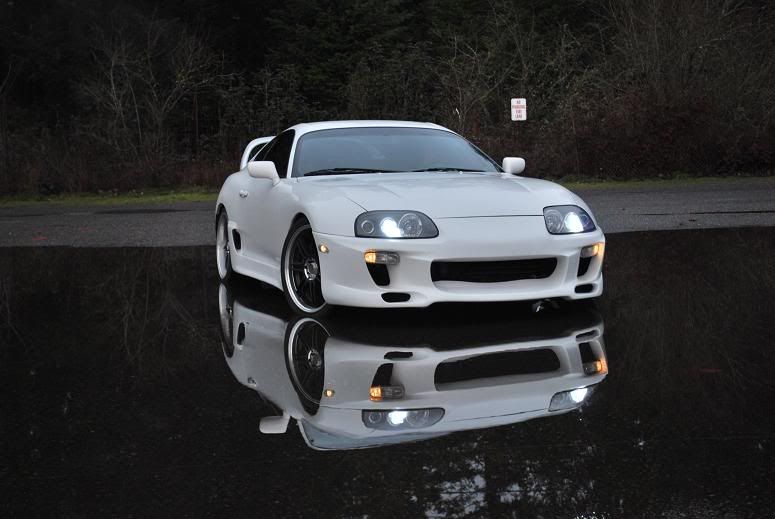

Mannnnn that would suck!!!! I told her to get a Honda to but she just wouldnt settle for anything less then a Supra
Here is what it use to look like.
gsx750r93
WARRIOR MANGO
Dec 1, 2006
103
seatac
Not sure on brand of the bumper..
