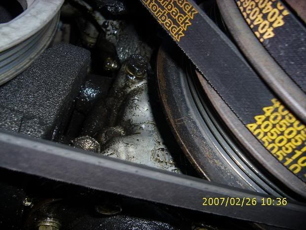

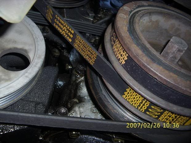

that is a weep hole on the front timing cover. seems like one of your seals needs to be replaced if in fact it leaks out that hole. it is either the front main seal or the oil pump driveshaft seal. replacing them involves removing the head so this may not be a job you want to tackle on your own being it's your first Soup
Why do you say this? I really don't think you have to take the head off. Can you prove that you do?
when my dad was helping me build mine and he installed the oil pump driveshaft seal the lip got ripped and it leaked oil out that weep hole.
the hole is there so that when you do get a leak it seeps out and does not fill the timing belt area with oil.
you do have to remove the head because it overlaps the rear timing cover which is where the seals are.
my dad tried that too and all he managed to do is fold the part of the head gasket that overlaps and tore it all to hell

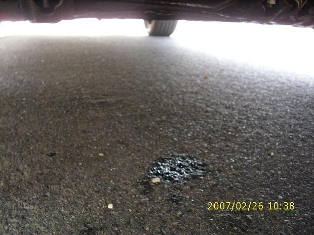

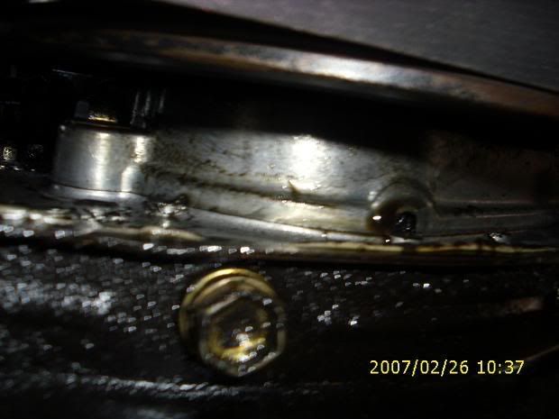

i got home, came inside then decided to go check for oil again. 30-45 mins passed i guess.
i got under and this is what i saw
it looks like the oil is not coming out of the weep hole, rather,
dripping down from wherever, running along the metal till it hits the weep hole, with the weep hole being the lowest point on the block (?) it then sits there till it gets too heavy and falls to the ground. That part is oily but unfortuantly it didnt show up in the picture
Check these photos out.
Why would you have to take the head off when the seals are easily accessible by just removing the lower timing belt cover?

That oil could be dripping down from the distributor, that is a common leak and an easy fix. Try to find the source by tracing it back up the block. If you need to you may have to do some cleaning so you can see the fresh drippage. A minor oil leak is more of a pain than anything so long as you keep a good eye on your level. Compared to gasoline oil is cheap and you can afford to leak a few drops so dont panic. That being said however it is preferable to find and fix the leak.

I parked it at my friends house and got under to see where exactly it was dripping from. its not near the weep hole as i suspected but it was falling from the oil pan (i think?) i dont know if that changes anything or not..
