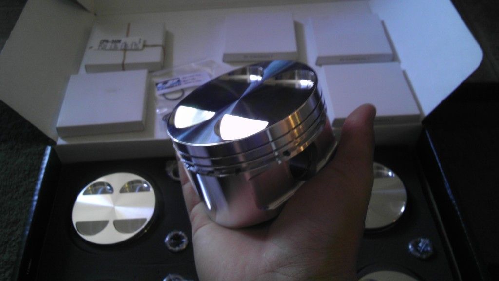

CP .020 forged Pistons Are Here!!

If I were you, knowing you have E-85 locally, I would of bumped it to 10:1.
A 3.0L 10:1 2JZ hit 1284 all boost....a 3.0L. That's 3.4L numbers....
Are you changing the rods? Eagle can work you up a set, so can Carillo. Eagles will be cheaper. All it really is is just a shorter 2JZ rod.

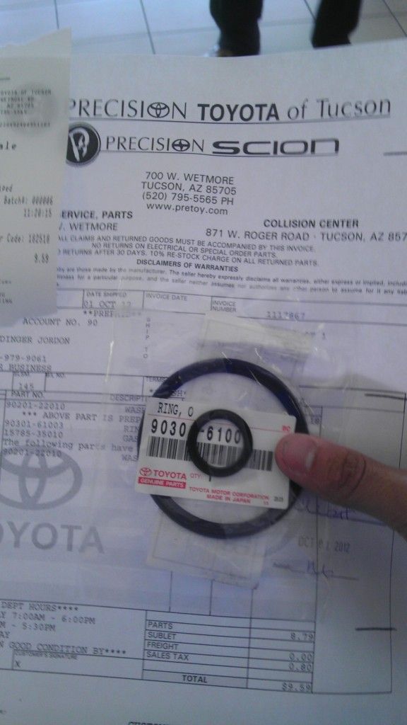

You need the one for the block as well. It is not in the kit. I had to order it separately. They should have it in stock. The Tacoma uses the same seal, it should be in stock.
Do you have a part number?

IBoughtASupra;1879296 said:
Instructions for oil cooler o ring replacement.
http://www.supraforums.com/forum/showthread.php?434413-Stock-oil-cooler-leak-fix
Part numbers needed for O-Rings. Should of post that sooner. :-/
http://www.supraforums.com/forum/showthread.php?656808-1JZ-Parts
Thanks Andy ill run back to Toyota right now i already got the ones in bold
90301-61003 ring, o large list 6.35 cost 4.76
15785-35010 ring , o small list 1.26 cost 0.94
90201-22010 washer , list 1.18 cost 0.88
90430-20016 gasket , union bolt list 1.75 cost 1.31
you sure im missing something?
