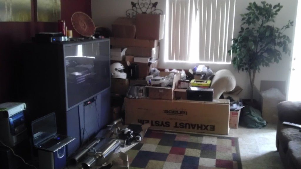

My house is taken over by this project
Well at least you have a helmet!
Looks good man, there is no better natural high than purchasing lots of car goods and watching it pile up while loved ones/friends question if they should be calling rehab for your addiction to motorsports.
Yeah the helmet was for the 7M Drag/Drift days was pretty fun.
Trust me lots of questions about my mental health towards the car have been raised lol.
