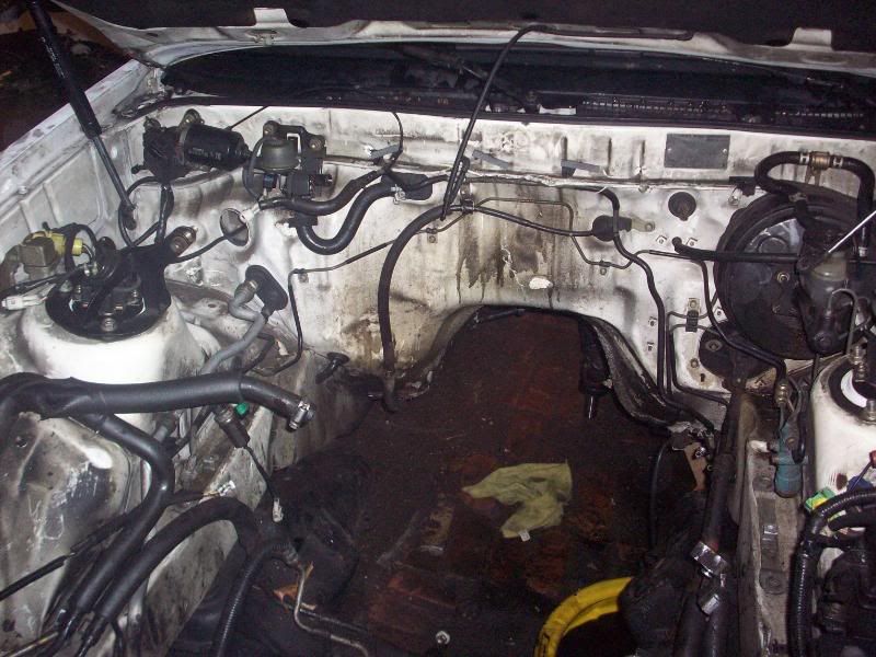

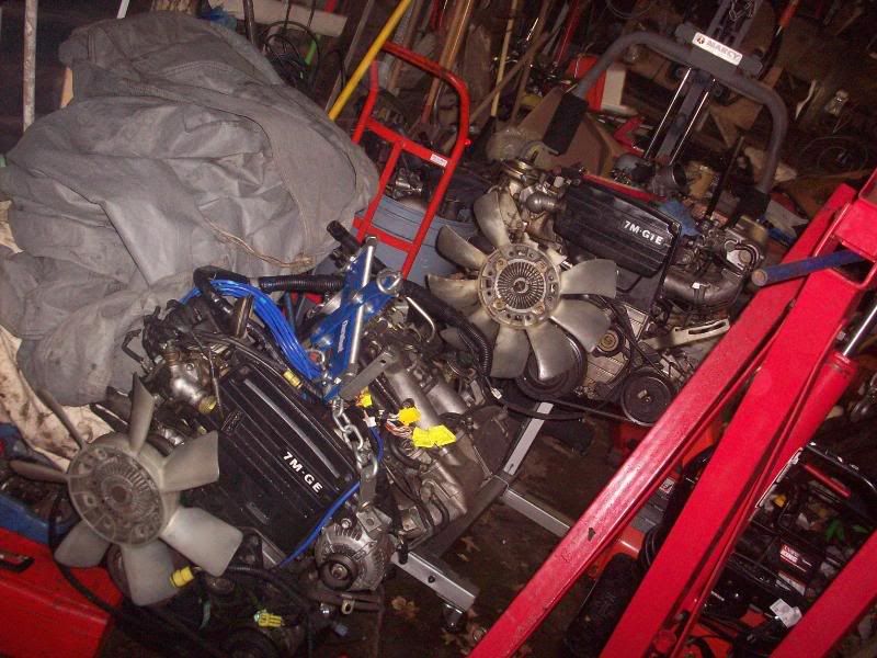

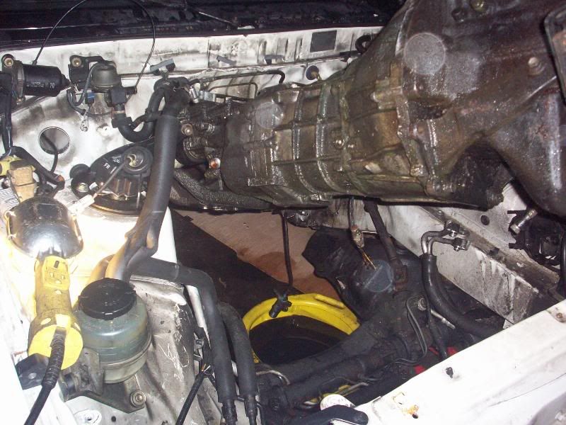

n/a was sold locally so now it comes out
now she is all in and hooked up, and starts and idle, still need to get an intercooler, tighten some clamps and fix some leaks , bleed clutch, install a fan and fan shroud, swap throttle cables, hook up some more vacuum lines, install hks ssq bov and piping, throttle body linkage and install my divorced downpipe. I know can see that this turbo is blown and dumping nothing but oil so now i have an excuse for an upgrade.
